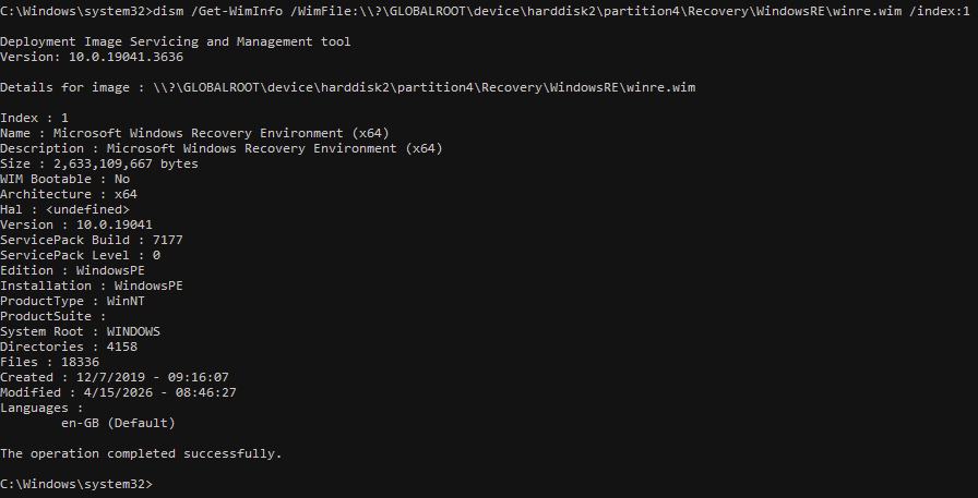

After copying winre.wim and enabling Windows RE, run:
dism /Get-WimInfo /WimFile:\\?\GLOBALROOT\device\harddisk2\partition4\Recovery\WindowsRE\winre.wim /index:1

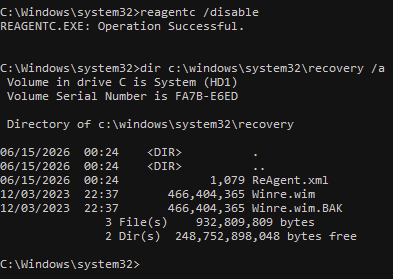

  1. Ramesh 181.6K Reputation points Volunteer Moderator
    2026-06-15T04:22:17.3633333+00:00
    On the subject PC, run:
    reagentc /disable
    dir c:\windows\system32\recovery /a
    Post the output.

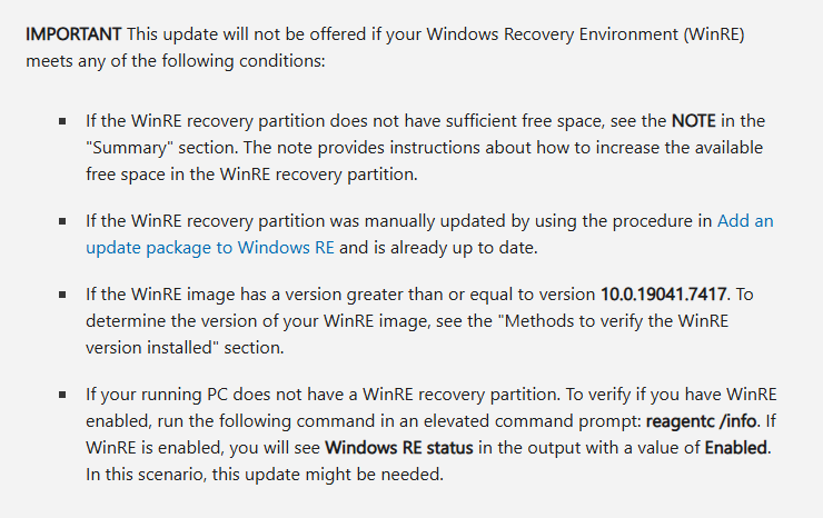

    Update:
    I found that, unlike the earlier WinRE updates, the June 2026 WinRE update strictly requires 250 MB of free space. If it's less, the update is not offered.
    Here's the latest → Winre.wim.

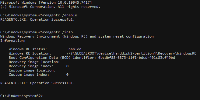

    On the subject computer, run:
    reagentc /disable
    del /a C:\Windows\System32\Recovery\Winre.wim
    Now, copy the downloaded Winre.wim to C:\Windows\System32\Recovery.
    Run:
    reagentc /enable
    reagentc /info
