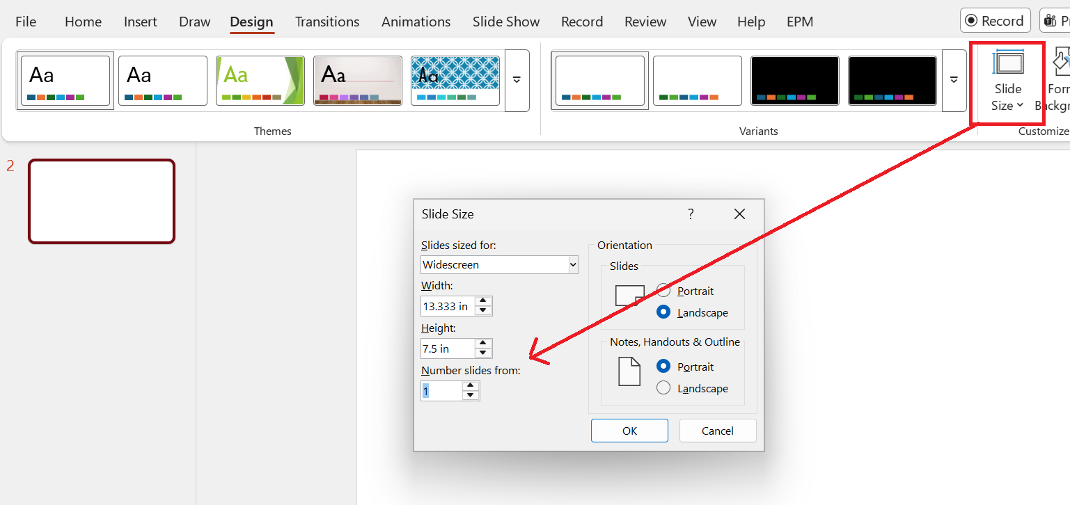

My slide overview and presentation is starting on slide 2? Used different views to try and find it, but it doesn't appear anywhere.

Hi @Jason Wozniak,
Based on your sharing, if the first actual slide in the deck shows as 2 in all views (Normal, Slide Sorter, Notes and Reading), I suspect the starting number settings of that presentation was changed to 2.
You can check this option in Design tab > Slide Size > Custom Slide Size > look for "Number slides from" and see if it's set to 2. If it is, change it to 1 and OK.
Hope my sharing would be helpful for your concern. If you have any questions or need any further clarification, please leave a comment here and I will be happy to continue to help you.

  1. Jason Wozniak 20 Reputation points
    2026-06-10T17:05:21.3166667+00:00
    This was not the case. There are no hidden slides shown in Normal or Slide Sorter. No thumbnails of slide 1. Slide 1 is just gone completely, with numbering starting at 2 for the first slide in Normal, Outline, Slide Sorter, Notes page & Reading view.
