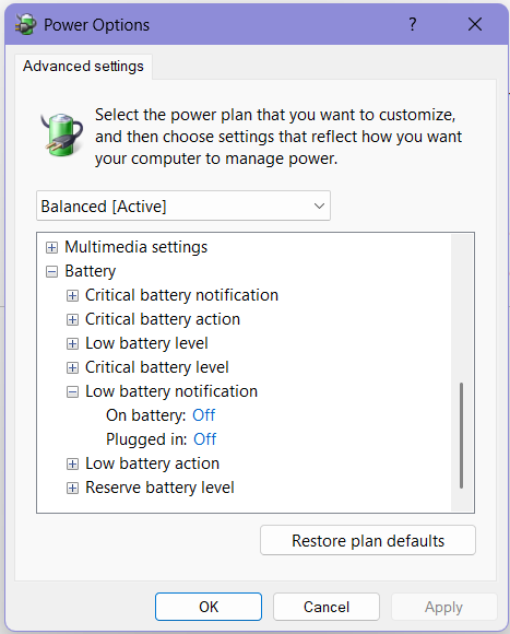

I usually start my day with my laptop unplugged and work off of the battery until I need to plug in the power cord. My low battery notifcation keeps defaulting to off in my settings and I always have to manually turn it on. Even when I lock my computer and log back in, it goes back to the default.
I go to Edit Plan Settings --> Change advanced power settings --> Battery --> Low battery notification --> On battery. Here, the setting for "On battery" defaults to Off and I always manually change it to On. If I don't, I do not get a warning and the laptop shuts down before I have a chance to plug in my charger.
Screenshot 2026-06-09 133224
How do I stop the low battery notification (on battery) to stop defaulting to off?
Thank you.

This behavior is usually related to how Windows stores background battery policy settings. The option you’re changing in Power Options is only the visible toggle, and if the underlying policy or threshold values aren’t properly aligned, the setting may revert back to Off after sign-in or power state changes.
If you're on Windows Pro version, please ensure the low battery warning policy is enabled
  • Press Win + R > type gpedit.msc > Enter
  • Go to: Computer Configuration > Administrative Templates > System > Power Management > Notification Settings
  • Set Low battery notification/warning = Enabled
You can also try these quick checking steps
1, Reset power plan
  • Open Command Prompt (Admin)
  • Run: powercfg -restoredefaultschemes
2, Set a valid low battery level
  • Go to Control Panel > Power Options > Change plan settings > Advanced
  • Expand Battery and set:
    • Low battery level = 10–20%
    • Low battery notification = On (both options)
Once these values are consistent, the notification should remain enabled and behave as expected.
Let me know if you need further assistance, feel free to ask me by clicking "Add Comment" or "Add Answer" if you cannot add comment so your response will be visible. Thanks for your effort.

    Windows uses a set of hidden battery policy settings that control when and whether low‑battery warnings appear. The “Low battery notification” option in the Advanced power settings UI is backed by the hidden Low battery warning policy.
    If this notification keeps reverting to Off, ensure that the underlying battery policies are configured consistently so Windows can trigger and keep the warning enabled:
    1. Configure the Low battery warning policy to Enabled.
      • This policy controls whether the OS displays a UI warning when the battery capacity crosses the low battery threshold.
      • Internally this is the LowBatteryWarning setting (BATFLAGSLOW, GUID bcded951-187b-4d05-bccc-f7e51960c258).
      • Set its value to Enabled (1) so the OS always shows the warning when the threshold is reached.
    2. Verify the Low battery threshold value.
      • This is the percentage at which the low‑battery action is taken and the low‑battery warning (if enabled) appears.
      • Internally this is LowBatteryLevel (BATLEVELLOW, GUID 8183ba9a-e910-48da-8769-14ae6dc1170a).
      • Ensure it is set to a reasonable percentage (for example, greater than 0) so the warning has a valid trigger point.
    3. Check the Low battery action setting.
      • This defines what Windows does when the low‑battery level is reached: Do Nothing, Sleep, Hibernate, or Shut Down.
      • Internally this is LowAction (BATACTIONLOW, GUID d8742dcb-3e6a-4b3c-b3fe-374623cdcf06).
      • Choose an action that gives time to react (for example, Sleep or Hibernate) so that even if the warning is missed, the device does not abruptly shut down.
    4. Review any battery‑related provisioning or power configuration tools.
      • Because these battery settings are hidden, OEM provisioning, Group Policy, or powercfg scripts can override the UI and reset the notification to Off.
      • Ensure no such configuration is repeatedly setting LowBatteryWarning to Disabled or changing LowBatteryLevel.
    Once LowBatteryWarning is set to Enabled and the LowBatteryLevel and LowAction values are configured appropriately, the low‑battery notification should remain On and trigger reliably when the configured threshold is reached.
