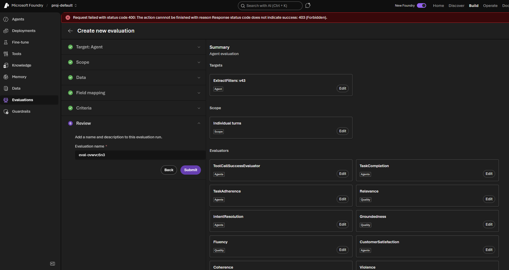

When submitting the evaluation run, the portal fails with:
Request failed with status code 400: The action cannot be finished with reason Response status code does not indicate success: 403 (Forbidden).

image (5)
