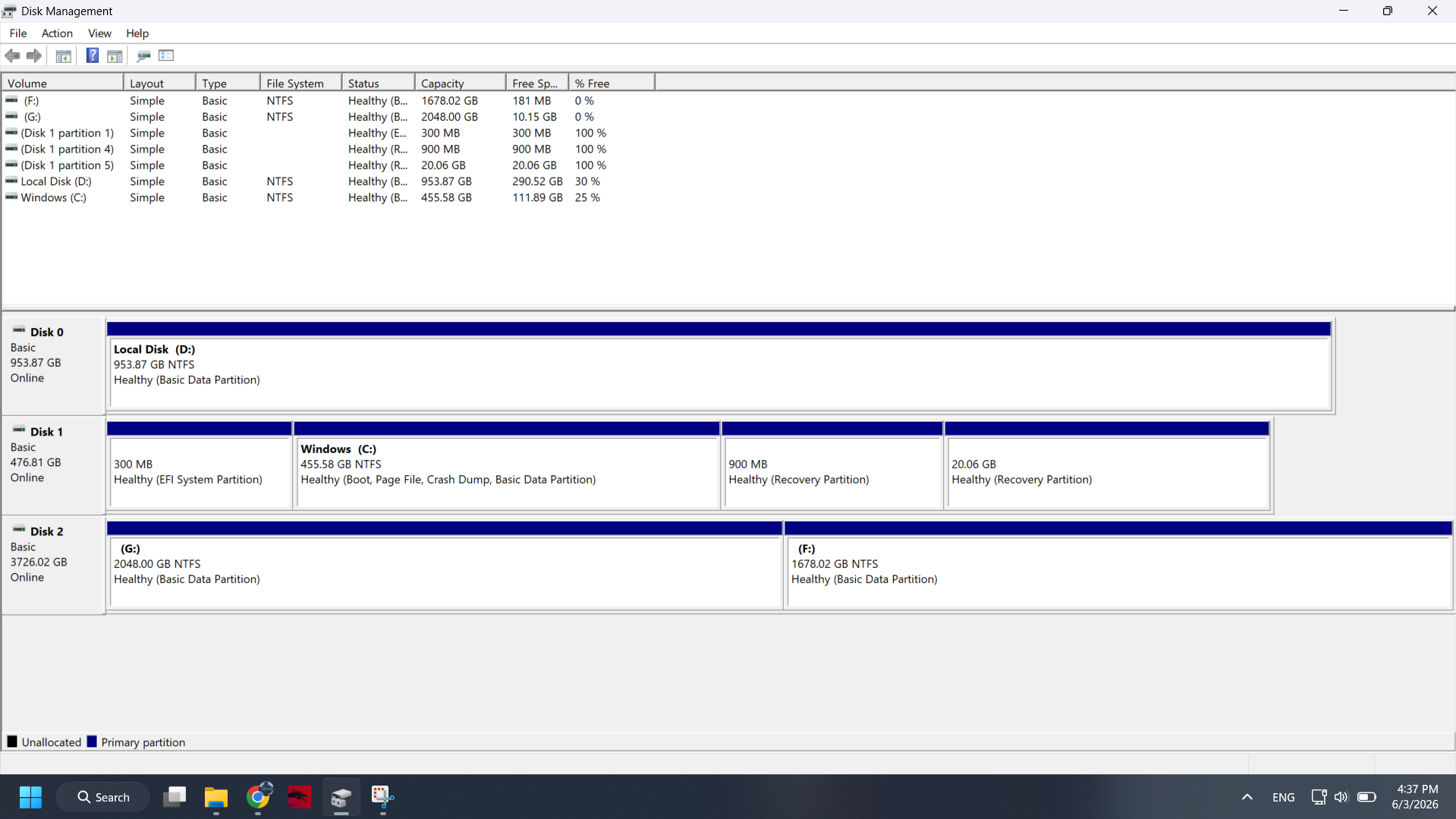

I Have an External HDD With 4TB of data Storage, separated into 2 disk files (f & g)
the F Works Fine But the G isn't Allowing Me to Enter for Some Reason so I Did the Usual changing the Access to Myself Even Though my Access Has nothing wrong & Works Just Fine
I Did some Searching & Google AI Suggested That I Use The CMD Check-up with This Prompt :
"chkdsk G: /f /r"
& I Have Around 1200 Movies On this Drive & Their Subtitle Files, But the CMD Has Given me Around 10 Hours to complete Which is Pretty Long & The HDD Usually Disconnects Itself Every Couple Of Hours, So My Question is Should I Abort it and find another fix cause I Have No Idea
