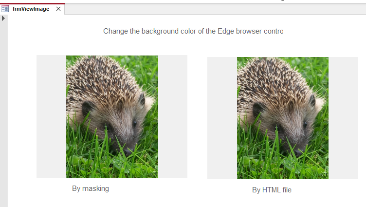

    After various searches and attempts, I finally have a solution.
    My first approach was to assign the browser's source control to a field containing the image prefix followed by the image path.
    In the VBA code, I hid the control using its size, and after the document fully loaded, I changed the background color using the ExecuteJavascrip method and restored the control's size.
    A few observations:
    I tried concatenating the prefix and the image path in the browser's source control. The value interpreted and displayed in the 'Insert Hyperlink' window is incorrect.
    The prefix is added twice, and the whole thing is enclosed in quotation marks.
    So I used a table field where I add the prefix to the image path.
    Using the Visible property to hide and then show the browser control doesn't work.
    When the visible=false property, the document is not loaded in the control.
    My second solution, using VBA, was to create an HTML document with the desired background color and insert the image into it.
    This document is saved in a directory.
    It is then loaded in the browser.
    This is the only solution I found to bypass the browser control's security with the image.
    After testing, the second solution is the fastest in terms of display.
    You can perform tests using the attached database.
    I've attached the TestNvEdge.txt file, which is the compressed file of my test database.
    I had to use the ".txt" extension due to the site's attachment restrictions.
    You need to change the extension of the TestNvEdge.txt file to TestNvEdge.zip to use it.
    Simply adjust the image paths in the table.
    For the 'MyImageWeb' field, you must leave the prefix before the image path.
    In the form's VBA code, you can adjust the variable Const tempHtmlPath As String = "D:\Documents\Tempo\access_edge_viewer.html", which defines the HTML document created by VBA.
    Yours sincerely.

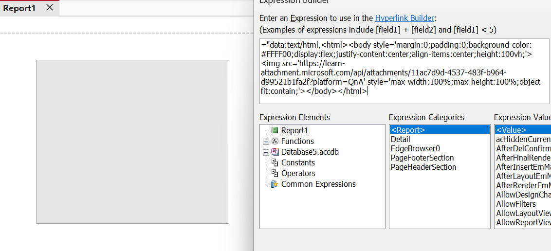

    2026-05-31T10:39:21.8133333+00:00
    Hello @jacky Perpète
    I recommend referring to the AI response first, as it already provides a useful explanation and is quite aligned with my understanding of the issue.
    However, I also spent some time testing different approaches (including rendering custom HTML, injecting content via VBA), and in my experience these methods are not consistently reliable. In many cases, they still result in a gray or blank area instead of displaying the image.
    Because of this, it appears to be an expected behavior, since the Edge Browser Control does not expose any property to control its internal background, and its behavior depends heavily on how the embedded Edge engine renders the content. As a result, based on my testing, there may currently be no reliable way to remove the empty gray/black space, at least using the approaches I have tried.
    I understand this may not be the answer you were looking for, but I hope sharing these findings helps clarify the current behavior. If anyone else has found a more reliable approach, it would be great to learn from that as well.
    Thank you for your understanding.
  4. AI answer
    2026-05-31T08:12:58.6+00:00
    The Edge Browser Control in Access exposes layout and border properties (such as BorderColor, BorderStyle, SpecialEffect, Width, Height, padding, etc.), but there is no property in the documented object model to change the internal page background that appears behind the rendered web content.
    The black bars you see are part of how the embedded Edge engine renders the page/image inside the control. Because the control is effectively a full Edge instance, its background is determined by the HTML/CSS of the page being displayed, not by Access form/report properties. Access can style the control’s border and surrounding layout, but not the internal background that appears when the content does not fill the entire area.
    To change that background color or make it match the report, the only available approach is to change the content being rendered (for example, host the image in an HTML page whose body background matches the report, and navigate the Edge Browser Control to that page). Access itself does not provide a setting to make the Edge Browser Control background transparent or to change those black bars directly.
