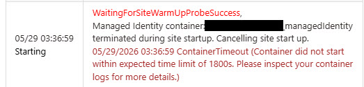

Attempting to deploy a fresh default WordPress on App Service deployment (to Premium tier, all new resources) in West US fails at the step deploying Azure Database for MySQL flexible server with error "An unexpected error occured while processing the request. Tracking ID: '32afd1de-f8ea-40e2-89c6-0b88d42ad7d8' (Code: InternalServerError)." Have reproduced this several times.
Probably for the same reason, my WordPress on App Service web site has been unavailable since Tue 9/23/2025 11:30 PM CDT perhaps at the onset of the issues covered in the Multi Service degradation event in West US 2: https://app.azure.com/h/GHRP-84G/07339d. When attempting to start site, swap site, or restore site, the site never completes the start, and a review of the platform log stream shows this error: "ContainerTimeout" starting WordPress on App Service in West US 2 following Multi Service degradation.

    For the existing WordPress site stuck with ContainerTimeout:
    • WordPress on App Service uses a containerized runtime; the app must successfully connect to Azure Database for MySQL during startup.
    • If the underlying MySQL flexible server is unavailable or degraded in the region, the container can fail to complete initialization, leading to ContainerTimeout (Container did not start within expected time limit of 1800s) and repeated warm‑up failures.

      • Because the error is raised at the MySQL flexible server step, and the running site’s container cannot complete startup, troubleshooting should concentrate on Azure Database for MySQL availability in West US 2 rather than on PHP/WordPress code.
      • For existing WordPress apps that show “Error establishing a database connection,” enable WordPress error logs and inspect for connection‑limit or connectivity errors as described in the open‑source troubleshooting guidance. This helps confirm that the app is blocked on database connectivity, not on application logic.

      • For the existing site, attempt a normal restart once Azure Database for MySQL in West US 2 is healthy; the container should then pass warm‑up without ContainerTimeout.
