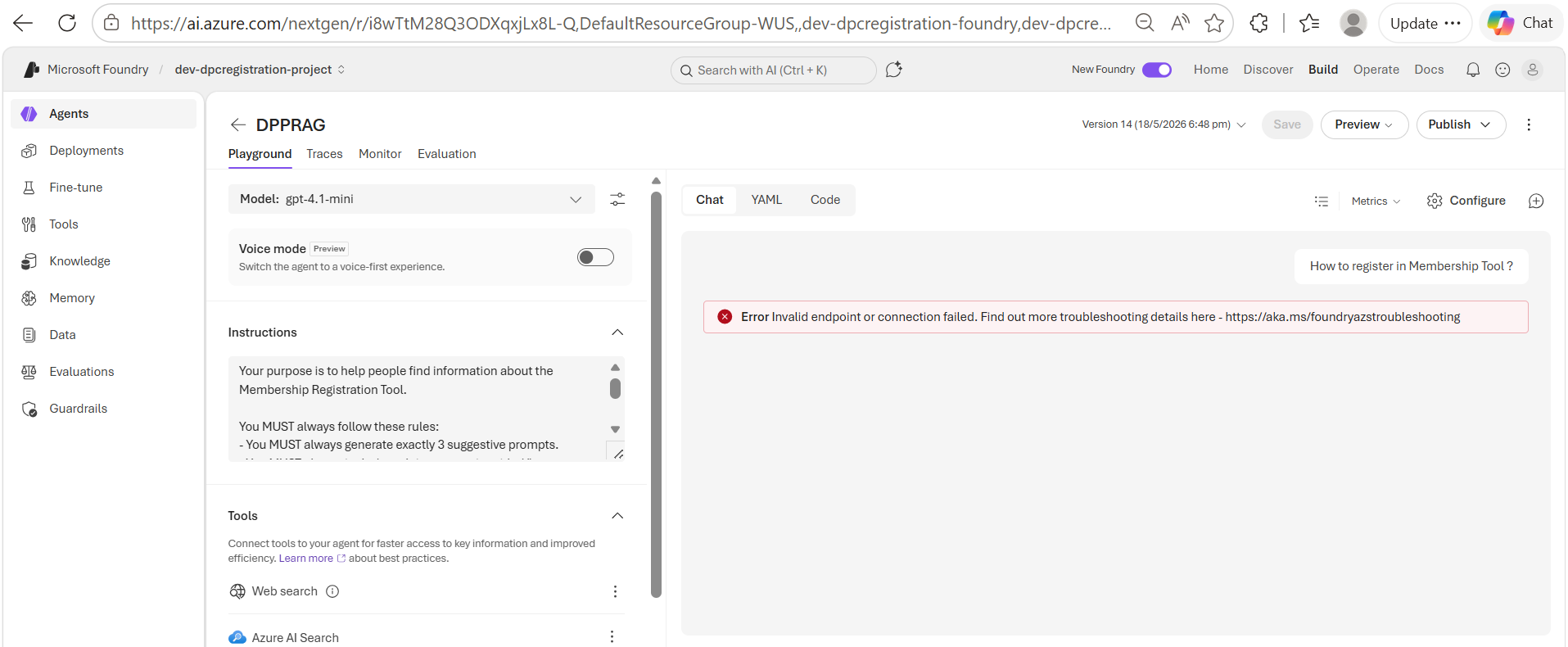

I am facing this error while trying to interact with workflows in new Azure AI Foundry
downstream_error{"error":"Error creating item on conversation","conversation_id":"conv_83409fdf3d9df0ba00xUC7HtWWfoYWTJ80V15EtlAJ1J3cB1BY","item_id":"","details":""}
Before it was working fine but facing it from 21st May 2026 onwards
