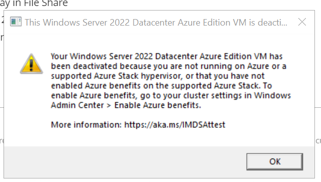

windows not activated in azure. I am getting this errorScreenshot 2026-05-21 080804.png (see attached). I have tried everything in this troubleshooting guide: https://learn.microsoft.com/en-us/troubleshoot/azure/virtual-machines/windows/activation-watermark-appears#how-to-determine-if-any-certificates-are-missing. but to no avail

The behavior currently observed on the Windows Server 2022/2025 Datacenter: Azure Edition virtual machines aligns with a recently identified issue impacting IMDS attestation certificate validation inside the guest VM on Azure Local environments.
Our engineering team is currently working on a permanent fix for this issue. Based on the current timelines shared by Engineering, the fix is expected to be delivered through a future cumulative update for the VM OS. At this time, it is unlikely to be included in the June release, with the next possible target being the July 2026 cumulative update.
As confirmed during our discussion, there has been no functional or workload impact observed in your environment so far. Based on the current engineering guidance, the activation warning can be safely ignored temporarily while awaiting the upcoming fix, provided workloads continue functioning normally.
The currently known impacts are limited to the following user experience items:
  • Pop-up message related to IMDS attestation during login
  • “Not activated” status shown in the GUI
  • Desktop watermark display
  • Limited personalization/customization settings
  • Certain Azure-specific features such as Hotpatching or Azure Hybrid Benefit may not function correctly until activation and attestation complete successfully
Hope this helps! Please let me know if you have any queries.

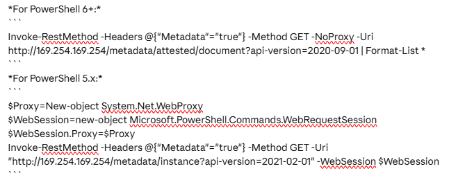

  1. Salamat Shah 740 Reputation points MVP
    2026-05-26T13:26:47.3466667+00:00
    Your VM is failing Windows activation because Azure cannot verify it’s actually running inside Azure infrastructure. This verification relies on the Instance Metadata Service (IMDS), which proves the VM’s identity to Microsoft.
