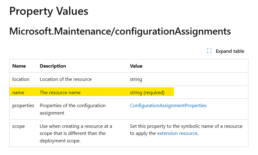

As documented in the ARM template reference for configurationAssignments, the name property of a configuration assignment is simply a string, it does not have to match the maintenance configuration name.
When assignments are created (especially via the Azure portal, dynamic scopes, or Policy), Azure often auto-generates a unique GUID-based name for the assignment to avoid naming collisions. This is why you see a UUID in the id field for some assignments.
