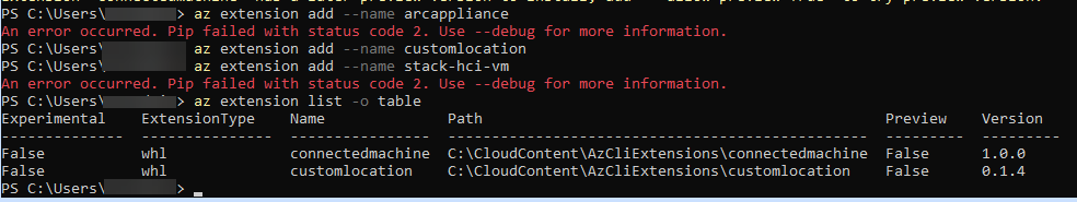

Reinstall clean versions
az extension add --name arcappliance
az extension add --name connectedmachine
az extension add --name customlocation
az extension add --name stack-hci-vm And
Then Provide output by runnning htis commands after Re-Install: az extension list -o tableLet me know the output if it worked?

Joe Comeau • 40 Reputation points
2026-06-29T23:17:17.27+00:00 Hi Manish,
Getting these errors for arcappliance and stack-hci-vm
Andy

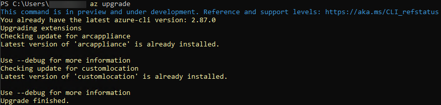

Remove-Item -Recurse -Force "C:\CloudContent\AzCliExtensions\*"Step 2: Clear Azure CLI cache
az cache purgeStep 3: Update Azure CLI (very important)

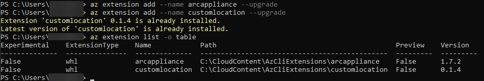

az upgradeStep 4: Reinstall extensions (clean)
az extension add --name arcappliance --upgrade az extension add --name customlocation --upgradeIf still Failing
