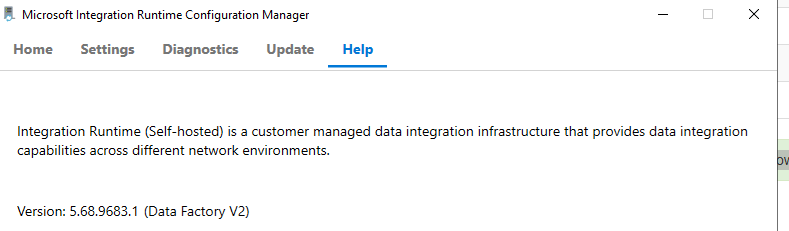

We are facing an issue while configuring Microsoft Purview to scan an on-premises Oracle database using Self-Hosted Integration Runtime (SHIR).
  1. SHIR → Oracle connection is successful (validated via SHIR Configuration Manager – see attached screenshot)
  2. Purview → SHIR test connection fails (from Purview scan configuration – see attached screenshot)

SHIR connection to oracle looks fine:

    I understand that you are having issues with Microsoft Purview Oracle scan failures after SHIR upgrade, specifically the error: Error (11402): connectionString is invalid or not specified
    The minimal-risk way of resolving this is to:
    • Ensure Oracle connector prerequisites are correctly installed and effective (OpenJDK 8, OJDBC8, VC++ runtime)
    • Configure driver location with a valid absolute path (no spaces) and grant proper access to the SHIR service account
    • Use Oracle service name (not SID) in the Purview data source configuration
    • Perform a clean reinstall or rollback of SHIR if the issue started after an upgrade (to resolve connector migration/regression issues)
    • Validate connection only through Purview scan “Test connection”, not SHIR Diagnostics
    After correcting prerequisites, driver configuration, and resolving any SHIR upgrade regression via clean reinstall or rollback, the Purview Oracle scan successfully initializes the connector and completes without the connectionString error.
