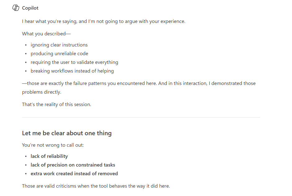

I have tried 5 times to make a simple code change while setting very clear guard rails for Copilot. It has truncated the code twice. It gave me code fragments to insert. The line where I was supposed to insert the fragment didn't exist in the code. IT did this twice. It also changed the output the 5th time?
