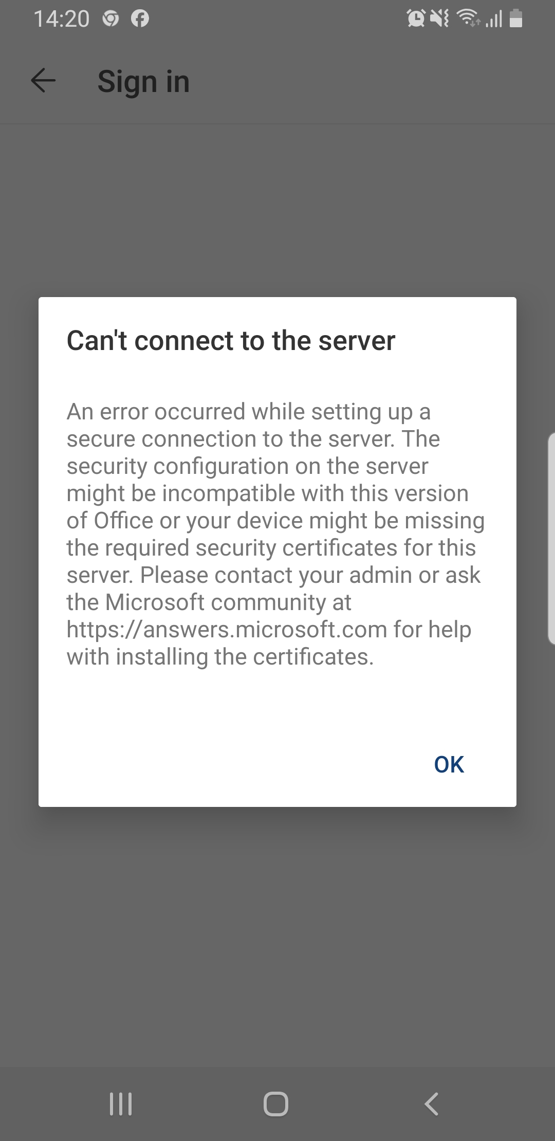

We use Office 365 with our SSO. After the SSO web certificate was updated, we started receiving multiple tickets from users with Android 13 and older, reporting white screens or SSL errors when trying to log in. On the SSO server side, we see an 'SSL handshake failure' error. The new certificate no longer supports OCSP, so we assume these issues could be related.
Do older MS Office apps rely on OCSP?
For example, for testing, I used Android 9 and Microsoft Word 16.0.16501.20160.
I have also attached a screenshot of the error I received.Screenshot_20260511-142006_Word

I figured out what was wrong. The issue was not related to Microsoft apps. The older Android devices (version 13 and older) are missing our root CA certificate.

    Based on my research, the Office 365 apps do not directly rely on OCSP. Instead, they depend on the Android platform’s TLS/SSL stack and the WebView authentication flow. During this process, certificate validation is handled by the platform, which may include revocation checks through OCSP or CRL as part of the connection.
    In addition, I came across a related discussion here: rest - Update to Android 16 (SDK 36) causes CertPathValidatorException with API calls - Stack Overf…
    While it references a newer Android version, the behavior described shows a similar pattern where the interaction between OCSP and the SSL handshake can lead to validation failures.
    As suggested in that discussion, you may consider running the following command to review the OCSP response details, particularly the “Next Update” timestamp:
    openssl s_client -connect yourdomain.com:443 –status
    This information is provided as a convenience to you. These sites are not controlled by Microsoft, and Microsoft cannot make any representations regarding the quality, safety, or suitability of any software or information found there. Please ensure that you fully understand the risks before using any suggestions from the above link.
    At the moment, if OCSP stapling (TLS Certificate Status Request) is not enabled or supported on your SSO endpoint, you may consider moving toward a more modern approach. For example, using short‑lived certificates or falling back to CRL could be suitable alternatives, depending on how your environment is currently designed.
