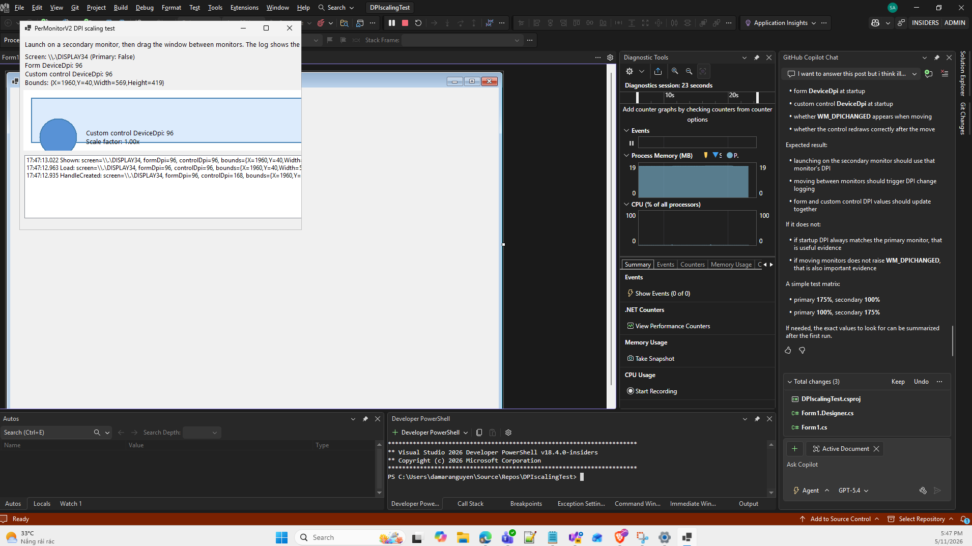

When using a custom WinForms control in a dual‑monitor setup with PerMonitorV2 DPI awareness, the application does not scale correctly based on the monitor where it is launched.

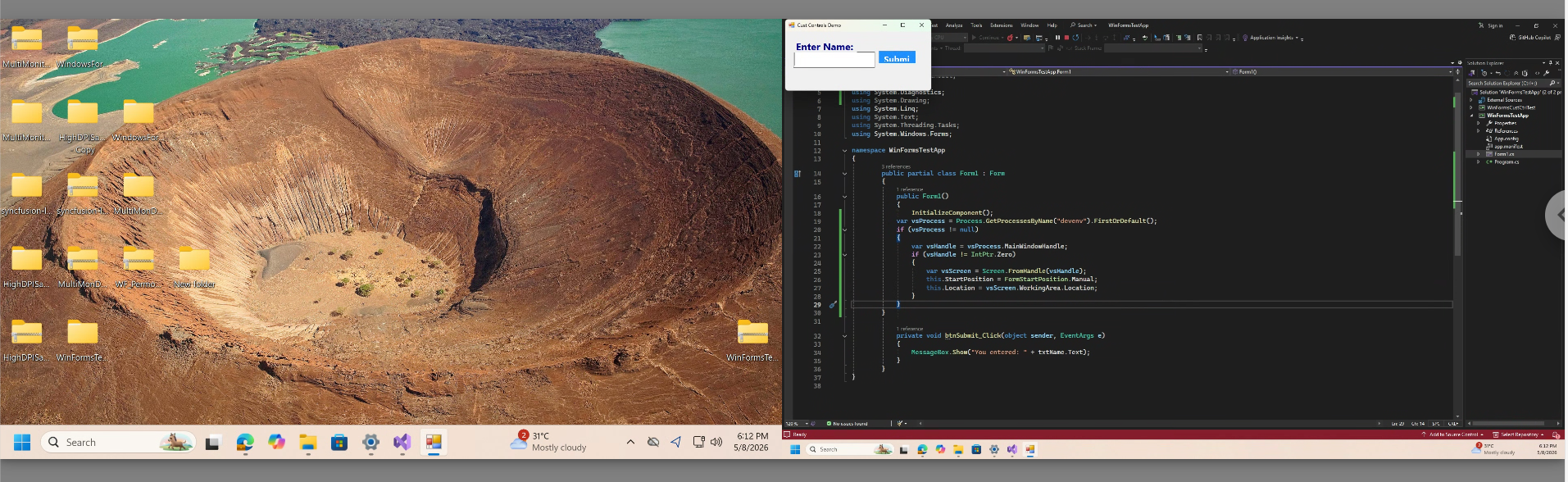

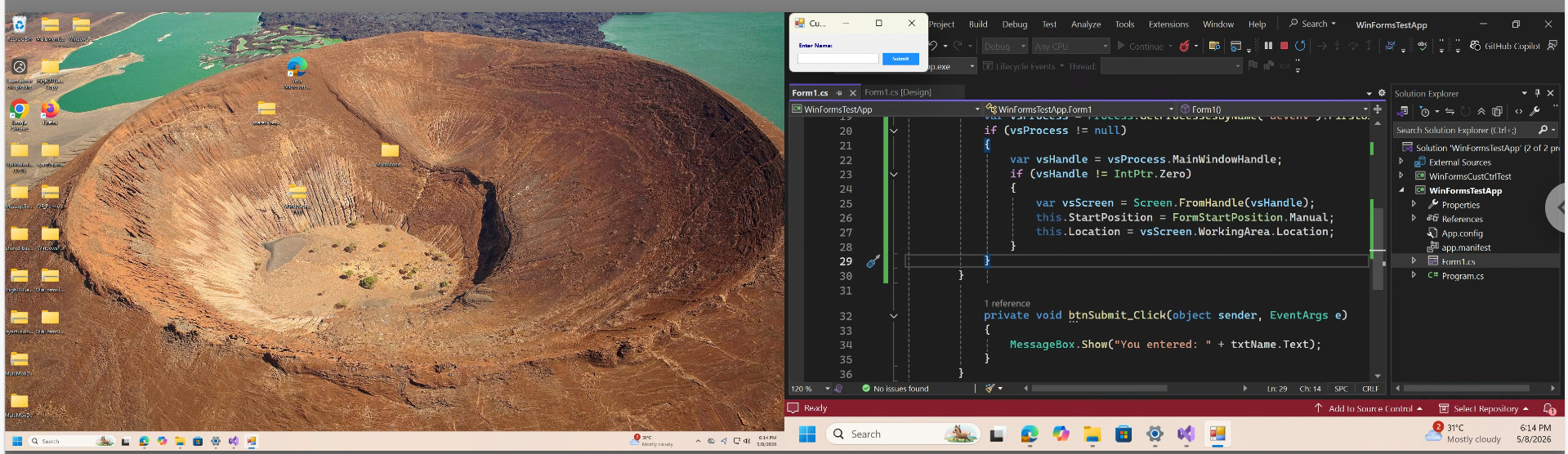

I tested the application in a configuration where primary and secondary monitors use different DPI scaling (175% and 100%, swapped between scenarios). Even when launching the application on the secondary monitor, the rendering appears to follow the primary monitor’s DPI.
Screenshots:
Primary 175%, Secondary 100% – Application Launched on Secondary Monitor
Image (2)
Primary 100%, Secondary 175% – Application Launched on Secondary Monitor
Image (1)
The application builds successfully, but the UI layout and scaling behave incorrectly at runtime:
  • The window is scaled based on the primary monitor instead of the active monitor
  • Moving the window between monitors does not adjust DPI correctly
  • Changing the primary monitor DPI affects rendering on the secondary monitor

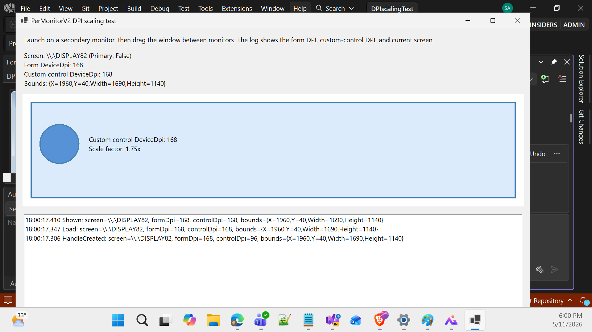

    We would like to clarify that the issue we reported is reproducible specifically in applications targeting the .NET Framework (WinForms) and does not appear in modern .NET (such as .NET 6/7/10), as you mentioned.
    In our testing with PerMonitorV2 DPI awareness enabled, the .NET Framework WinForms application exhibits the following behavior:
    • The application scales based on the primary monitor DPI, even when launched on a secondary monitor with a different DPI setting.
    • Initial window rendering does not respect the DPI of the monitor where the application is opened.
    • Moving the window between monitors does not consistently trigger proper DPI recalculation or layout adjustment.
    • Changing the primary monitor’s DPI affects rendering on other monitors, indicating that system DPI is being prioritized over per-monitor DPI at runtime.
    Based on our observations, this appears to be a limitation of WinForms under the .NET Framework, where full PerMonitorV2 DPI behavior is not completely supported especially in scenarios involving custom controls and multi-monitor environments with mixed DPI settings.
