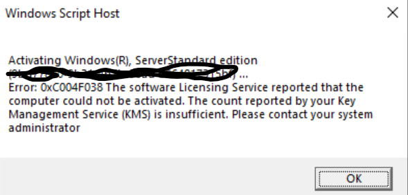

I am activating Windows 2022 Standard Servers using KMS. However, right now my KMS server is stuck on a 4 count license and I cannot get the 5th one activated (which is the min). I have tried to deploy new machines that are sysprepped. When I try to activate those machines, I get the following. What is KMS looking for that it cannot get the 5th one activated? With the sysprep, I have confirmed a new SID is being generated but I can't get them to activate without receiving the message below. Any ideas of how to troubleshoot this or is there something in the sysprep process I should do to allow KMS to see this server as unique?

    Error 0xC004F038 means the KMS host’s current activation count is below the required threshold. For Windows Server, the KMS count must be at least 5 before any server can be activated.
    In this situation, the KMS host is correctly reporting a count of 4, so all additional activation attempts fail with 0xC004F038 until the host sees a fifth unique, qualifying KMS client.
