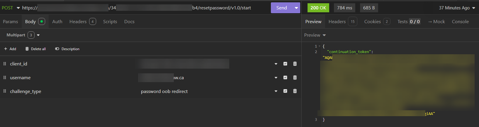

I have followed documentation "Email OTP send event reference", and successfully setup a working QA version where I am able to send an OTP with a custom email template and provider.
When I tried to recreate this and essentially duplicate everything (App Registration, Function App, Custom Authentication Extension) for another dev environment, I am getting the following error in Step 2.
Step 1: /resetpassword/v1.0/startUser's image
Step 2: /resetpassword/v1.0/challenge
	"error": "invalid_request",
	"error_description": "AADSTS1100001: Non-retryable error has occurred. Underlying error code: 1003002. Trace ID: 55fa7e04-881d-464c-9b04-c17bceb50400 Correlation ID: c73ec278-6437-45e9-b3a0-01e7207cde8f Timestamp: 2026-04-23 16:28:01Z",
	"error_codes": [
		1100001
	"timestamp": "2026-04-23 16:28:01Z",
	"trace_id": "55fa7e04-881d-464c-9b04-c17bceb50400",
	"correlation_id": "c73ec278-6437-45e9-b3a0-01e7207cde8f"
I have set it up identically so I am not sure where it is erroring out and what the error is.
