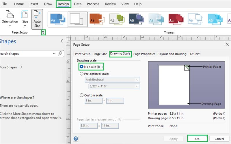

    1/ Reset the drawing scale first
    This is the most commonly missed step.
    • Go to Design tab > Page Setup (click the small arrow in the corner)
    • Click the Drawing Scale tab
    • Set it to No Scale (1:1)
    • Click OK

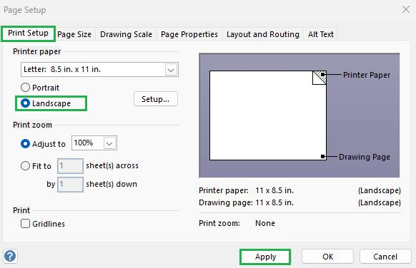

    2/ Align the drawing page size with the printer paper size
    • Open the org chart page in Visio, then go to Design and open Page Setup.
    • On the Print Setup tab, set Printer paper to Letter 8.5 × 11 and confirm Landscape.
    • Next, on the Page Size tab, set the Drawing page to the same Letter size so the drawing page and printer paper match.
    • Review the preview thumbnail in Page Setup; if the drawing page is larger than the printer paper, Visio will tile the print across multiple pages.

    4/ Set print scaling from Print Setup and validate in Print Preview
    • Go to File, then Print, and use the preview pane to confirm the layout before printing.
    • Select Page Setup from the Print screen, then open the Print Setup tab.
    • Under Print zoom, choose Fit to, then set 1 sheet across and 1 sheet down to keep the org chart on a single page. Reduce or enlarge a drawing when you print it - Microsoft Support
    • If the result still appears too small, switch from Fit to to Adjust to and test a fixed percentage while watching the preview, because fixed scaling prevents automatic over shrinking when extents are larger than expected. Printing and print preview in Visio - Microsoft Support
