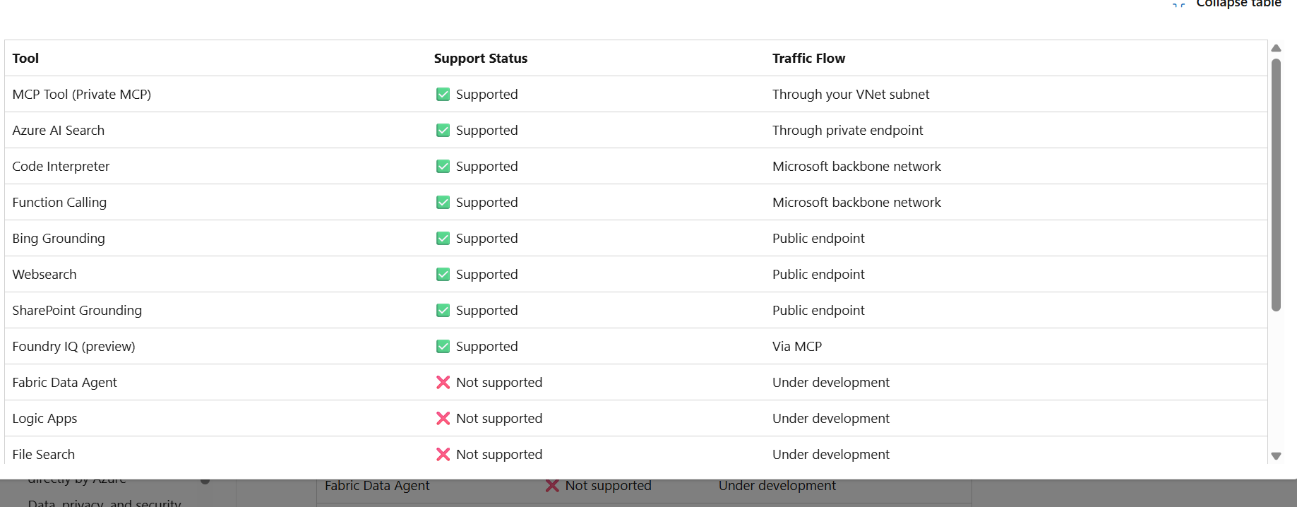

Re-emphasizing again for users restricted to use managed identity only.
As AI search is supported through private endpoint only. Using Public IPs won't work even with managed VNET.
We should create AI search resource in same region as of foundry and VNET and connect them through private endpoints.
Once they are secured with VNET, you can use a VM's Bastion browser (internal subscription has restriction)/VPN Gateway (p2s works/s2s is also supported) in same VNET.
