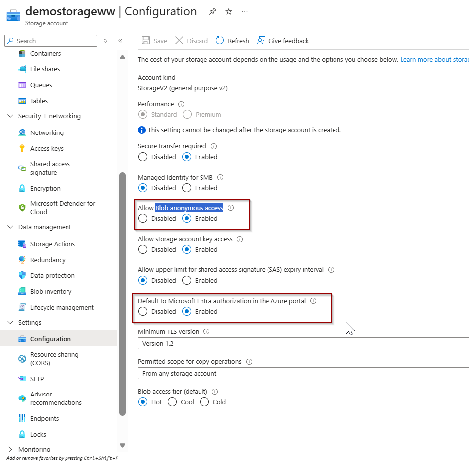

I have configured Azure Front Door with a Storage Blob as the origin to access it via the AFD endpoint. The storage account has been created with public access enabled, along with Microsoft Entra authorization and blob anonymous access enabled, as shown below, to allow public access
Note: Anonymous access is not recommended for production environments due to security concerns. Kindly disable anonymous access and enable private access.

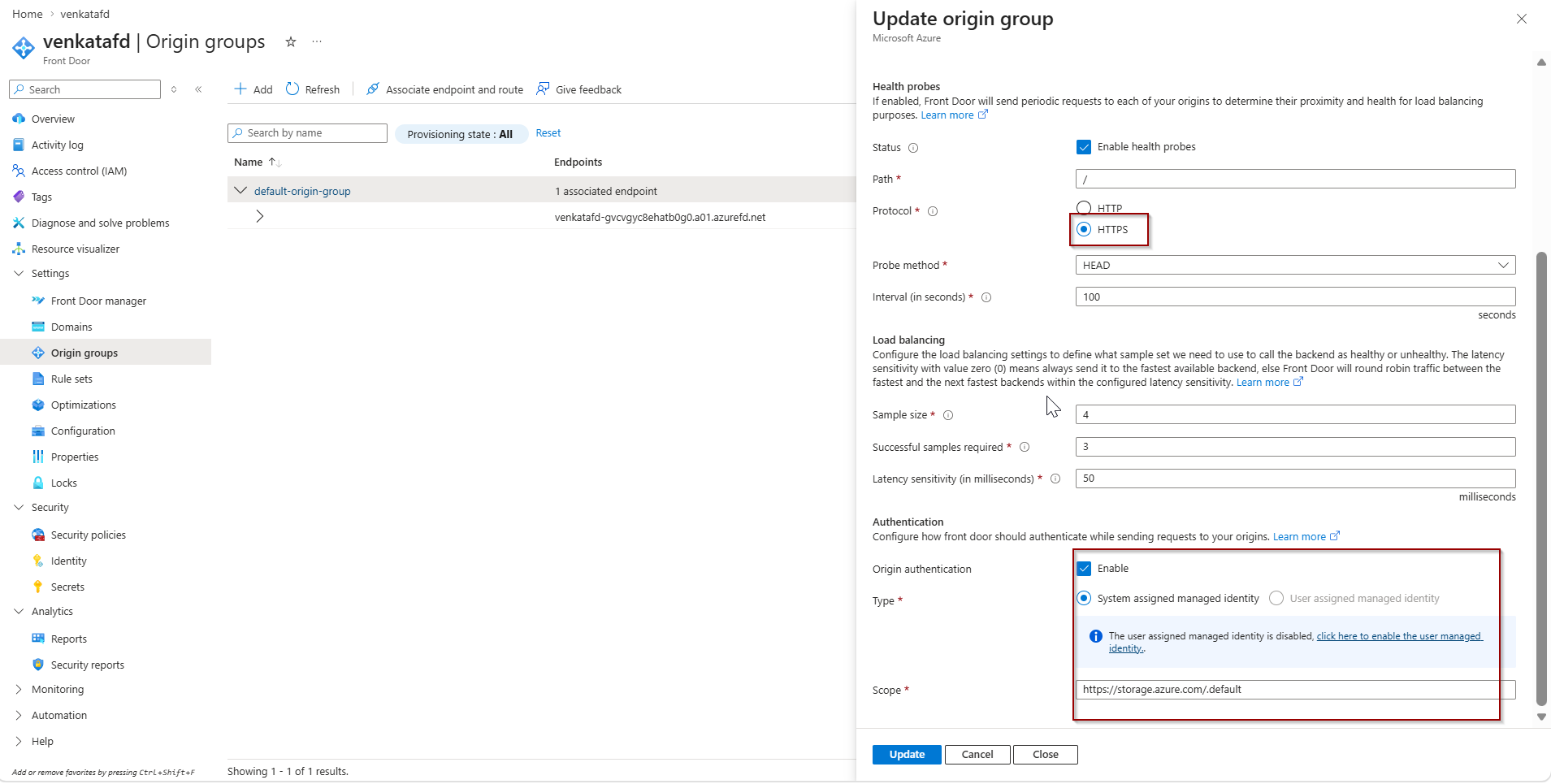

Please verify that origin authentication is enabled and set to System Managed Identity. Also, ensure that the Storage Blob Data Contributor role is assigned to the AFD identity. Additionally, confirm that the origin protocol is configured to use HTTPS.

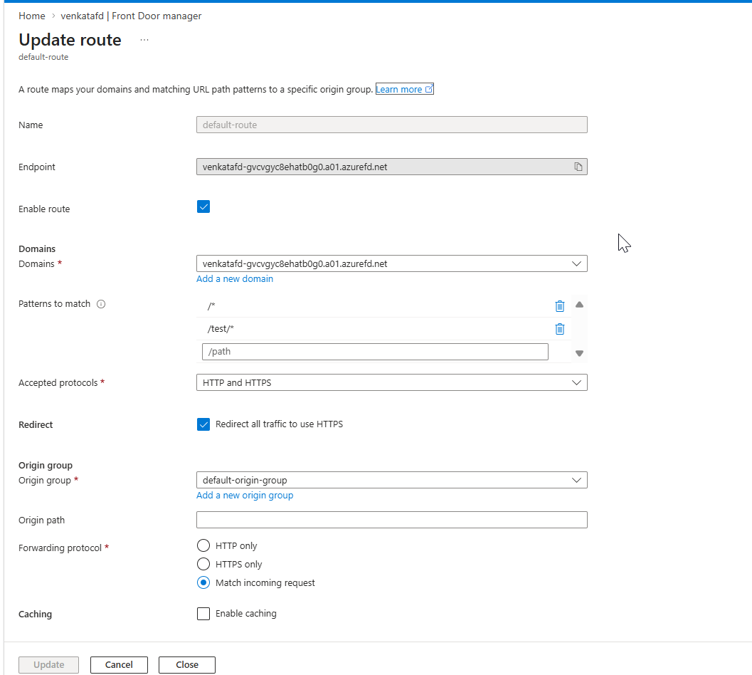

AFD route Configuration, Make sure Pattern to Match should be /* (to access all request)

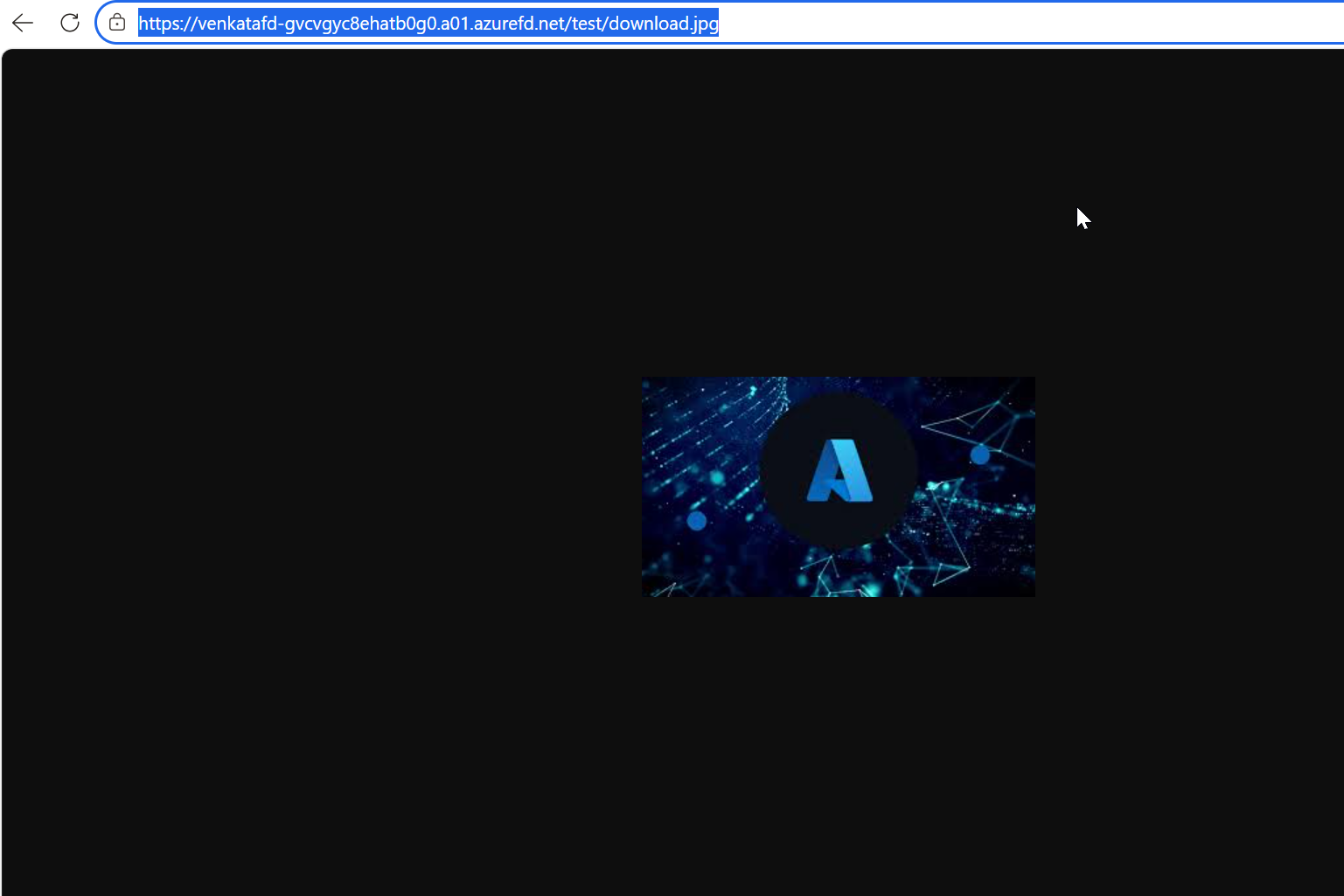

Please find my AFD result below.
