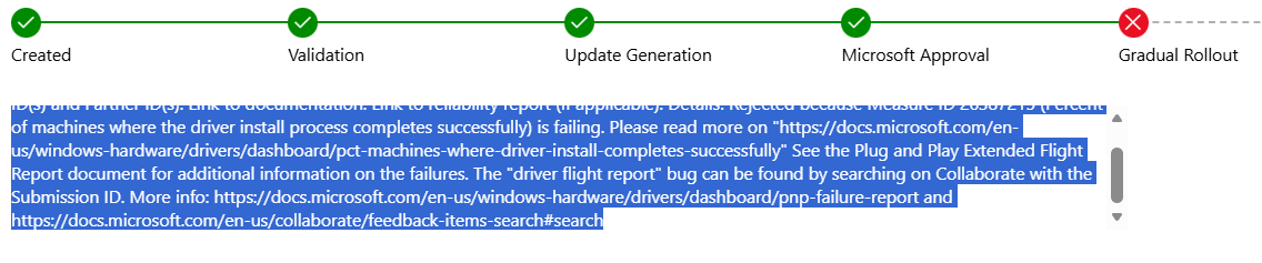

How to fix wu Submission issue?
2026-04-06T06:03:30.56+00:00
Rejection Theme: Measure Failure Rejection Reason: Systemic Measure Failure Provide Measure ID(s): 26387215 ADO bugId: 61631302: Bug ID(s) and Partner ID(s): Link to documentation: Link to reliability report (if applicable): Details: Rejected because Measure ID 26387215 (Percent of machines where the driver install process completes successfully) is failing. Please read more on "https://docs.microsoft.com/en-us/windows-hardware/drivers/dashboard/pct-machines-where-driver-install-completes-successfully" See the Plug and Play Extended Flight Report document for additional information on the failures. The "driver flight report" bug can be found by searching on Collaborate with the Submission ID. More info: https://docs.microsoft.com/en-us/windows-hardware/drivers/dashboard/pnp-failure-report and https://docs.microsoft.com/en-us/collaborate/feedback-items-search#search
