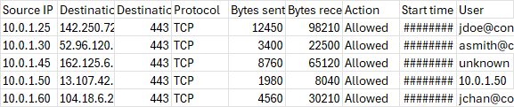

I chose Checkpoint CSV and have upload logs file with these field.
and try one with these headings.
Time Blade Action Type Severity Confidence Level Suppressed Logs Source Source User Name Machine Name Destination Protection Type Sent Bytes Received Bytes Malware Family Malware Action Protection Name Resource
I also try the sample data that Microsoft listed for Checkpoint CSV
All of them don't work. Any ideas?
