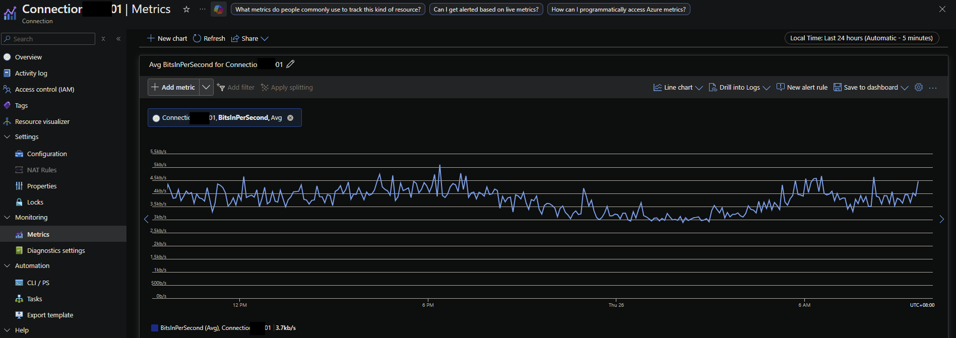

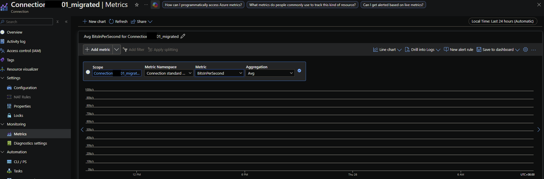

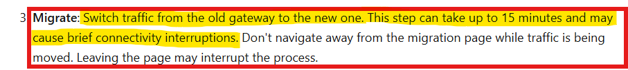

Additionally, after migrating traffic from the old gateway to the new one, you may experience network drops for a few minutes (up to 15 minutes). You can plan for this accordingly. See the screenshot below:

Migrate traffic: Select the new gateway and click Migrate traffic. Azure transfers BGP sessions, routes, and ExpressRoute peering to the new gateway. Expect a short BGP flap, but no downtime. Wait until this process finishes (about 5–15 minutes).

Post-migration checks: Confirm that BGP neighbors are active on the new gateway. Use ping or iPerf to test connectivity from your VMs to on-premises. Review your ExpressRoute metrics (bytes in and out) to ensure traffic is flowing correctly.
