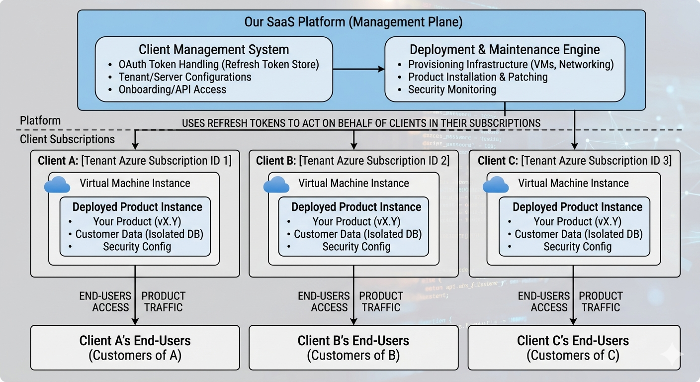

I'm building a .NET Web API where users (with any Microsoft account – work/school or personal like Outlook/Gmail) can connect their Microsoft account. After connecting, my backend needs to programmatically create Azure resources (VMs, web apps, etc.) on their behalf using the Azure Resource Manager API.
1. Requirement
  • Users log in to my app using email/password (local JWT authentication).
  • They then link their Microsoft account via OAuth 2.0 (delegated permissions) to allow my app to manage Azure resources in their subscription.
  • My app must obtain a refresh token with https://management.azure.com/user_impersonation scope so it can later acquire access tokens and call ARM APIs to deploy resources.

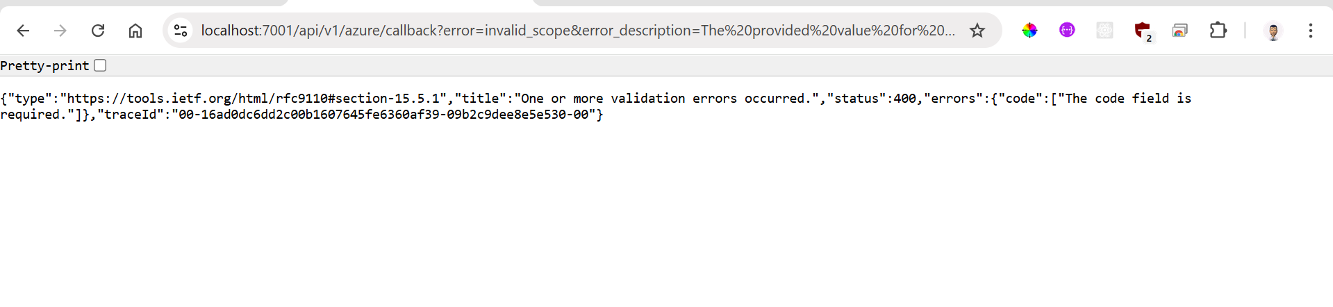

2. Problem When I initiate the OAuth flow using the v2.0 endpoint with the scope https://management.azure.com/user_impersonation, personal Microsoft accounts (e.g., @outlook.com, @gmail.com) fail with the following error after login:
AADSTS500200: User account '{email}' is a personal Microsoft account. Personal Microsoft accounts are not supported for this application unless explicitly invited to an organization.
it's also happening via tried with Work/school accounts. The same error occurs even if I use the v1.0 endpoint with resource=https://management.azure.com/ instead of scopes.

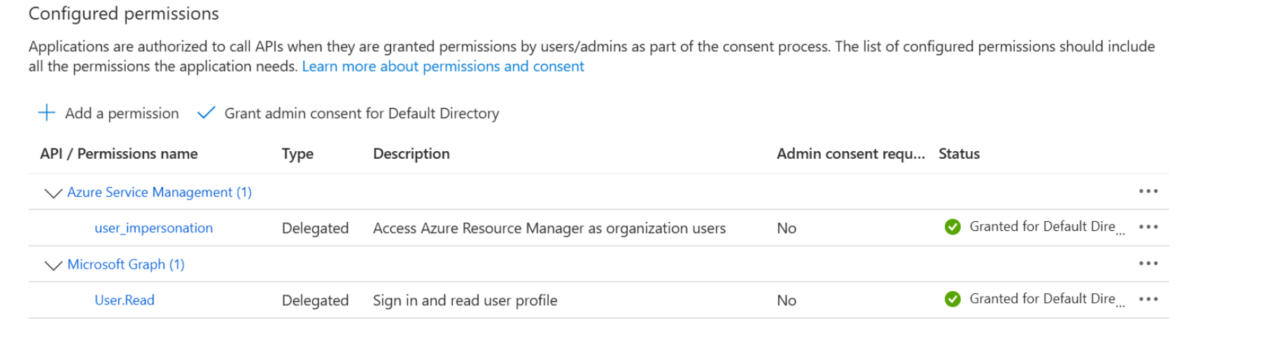

Added and granted admin consent for both Microsoft Graph (User.Read) and Azure Service Management (user_impersonation) delegated permissions.
