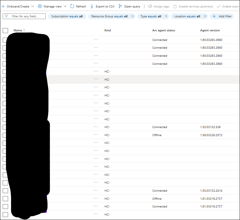

Hi Team,I have azure stack HCI clsuter in which few of my machine are giving the error
INFO AZCM0044: Resource Already Exists
INFO Please retry the command with a resource name. A valid resource name contains only alphanumeric characters, '-' , '_' and '.'.
INFO For more troubleshooting tips, please refer to https://aka.ms/arc/azcmerror
FATAL resource name 'VMName' already exists. Please specify a different resource name

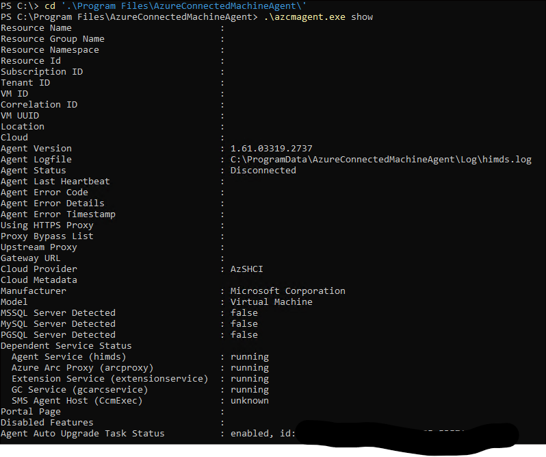

I ran command azcmagent.exe disconnect --force-local-only and than ran the connect command but it give the above error.
in some article i saw they are saying to clear the stale registration Azure arc but i am unabel to see the remove/delet option in azure arc.
Kinldy suggest.

    The error indicates that the Azure Arc resource with the specified name already exists in Azure, so azcmagent connect cannot create a new resource with the same name. This typically happens when a machine was previously connected and then cloned or reconnected without first cleaning up the existing Arc registration.
    The supported way to resolve stale or conflicting Arc registrations is:
    1. On the affected server, run:
         azcmagent disconnect --force-local-only
      This removes the local association but does not delete the Azure resource.
    2. In Azure, delete the existing Arc-enabled server resource that corresponds to this machine name so that the name is freed. The context describes that each connected machine must have a unique resource identity; cloning or reusing a connected image causes conflicts and 429/"already exists"-type issues.
    3. After the stale resource is removed from Azure, run azcmagent connect again on the server, using a unique resource name if needed.
    If these machines were created from a golden image that was already connected to Azure, each clone must be “specialized” and then connected individually:
    • Install the azcmagent package in the golden image, but do not run azcmagent connect on the image itself.
    • For existing clones that share the same resource identity, run on each clone:
        azcmagent connect ...    # with appropriate credentials and a unique resource name
    This ensures each Azure Stack HCI node or guest VM has its own unique Arc resource and prevents the “resource already exists” error.
