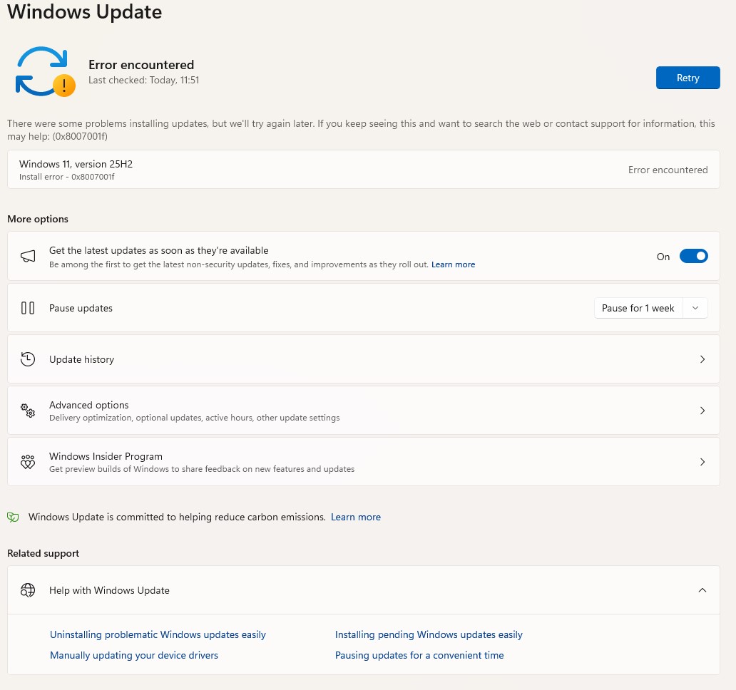

I keep getting the error 0x8007001f. I searched for solution and tried multiple options but result is still the same. Please advise.

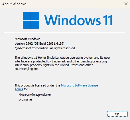

  2. DaveM121 930.3K Reputation points Independent Advisor
    2026-03-08T06:16:20.8066667+00:00
    If your version of Windows 11 is fully up to date on version 24H2, you may be able to perform a quick update to version 25H2 using a small enablement package.
    1
    Click your Start Button, type winver and hit Enter
    Please provide a screenshot of the resulting dialog.
    2
    Open the Settings App
    Go to Windows Updates
    Please provide a screenshot of that window
