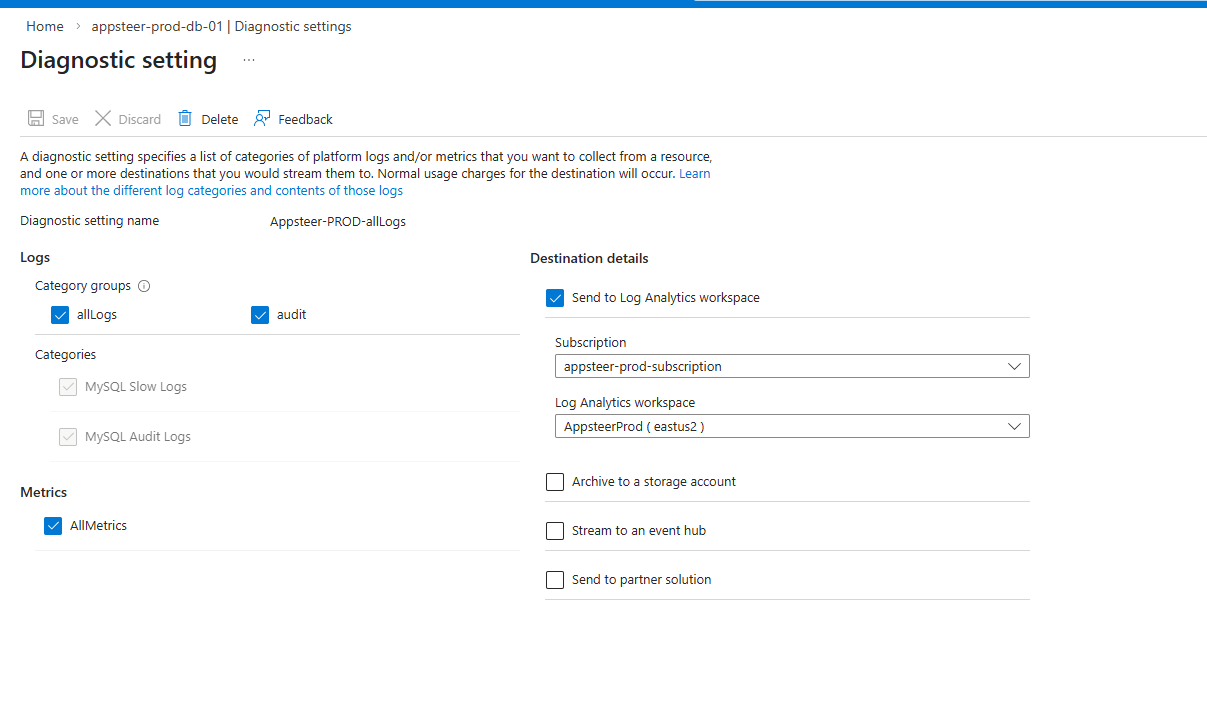

2026-03-06T10:20:18.7933333+00:00 Hi Bharath, Thanks for the reply, I went through the details you mentioned above, We actually enabled all the diagnostic settings and required server parameters. Actually we were getting all the logs before and the log-analytics was working fine, Form recent days we are not able to fetch the logs. Also we haven't made any changes in the configuration.

2026-03-11T09:39:20.5+00:00 Hi Bharath, We have cross checked for the diagnostic setting config which you suggested, Everyhting is configured properly but still not able to fetch any logs.
Bharath Y P • 10,610 Reputation points • Microsoft External Staff • Moderator
2026-03-12T10:50:40.03+00:00 Hello Punit katnalli, Based on the screenshot, your configuration for the workspace allLogs and audit setting is correct. Since the settings are visually correct but logs have stopped flowing. Since the settings are visually correct but logs have stopped flowing. we need to look at the Ingestion Health and Resource Provider status.
- Check the "Ingestion Latency" and Error logs: If the configuration is right but data is missing, the workspace itself usually records why it isn't receiving the data. Run this query in your Log analytics workspace:
_LogOperation | where TimeGenerated > ago(24h) | where Category == "Ingestion" | where Level == "Warning" or Level == "Error" | where Detail contains "MySQL" or Detail contains "<Your Workspace name>" | project TimeGenerated, Operation, Level, Detail, _ResourceIdIf you see errors here, it will likely mention "Subscription not registered" or "Throttling."
- Verify the "Resource-Specific" vs "AzureDiagnostics" Mode: In your screenshot, you are using the modern Category Groups (allLogs). This almost always defaults to Resource-Specific tables.
