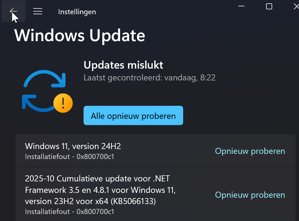

I am trying to update to Windows 11, version 25H2, but I am getting an Install error - 0x800700c1 when trying to update.
It mostly tries to "correct" this by trying to install older, missing updates, but these fail as well with the same error:
  • 2025-10 Cumulative update for .NET Framework 3.5 and 4.8.1 for Windows 11, version 23H2 for x64 (KB5066133)
  • Windows 11, version 24H2
I think somewhere down the line, some older update failed and this triggered some cascading effect for newer updates.
My current image version is 10.0.22631.5768
My current version of windows is 23H2, build 22631.5768
I have tried a simple restart, running Windows Update Troubleshooter, the repair update, but those updates still fail.
From time to time
I tried running dism.exe /Online /Cleanup-image /Restorehealth via CMD as admin but I get the following error:
The source files could not be found.
Use the "Source" option to specify the location of the files that are required to restore the feature. For more information on specifying a source location, see https://go.microsoft.com/fwlink/?LinkId=243077.
The DISM log file can be found at C:\Windows\Logs\DISM\dism.log
Screenshot below (using the dutch version of windows)
I've tried an in‑place upgrade with the latest 25H2 ISO from windows, but that installation failed as well
