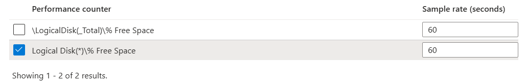

Issue Description: We have configured a Data Collection Rule (DCR) using Azure Monitor Agent (AMA) to collect the following performance counter:
\LogicalDisk(*)% Free Space
The DCR is successfully associated with the target virtual machines and is correctly pointing to the designated Log Analytics Workspace. However, when querying the Perf table in Log Analytics, we are only receiving records with:
ObjectName: LogicalDisk
CounterName: % Free Space (and Free Megabytes)
InstanceName: _Total
We are not receiving individual disk instances (e.g., C:, D:, etc.), which prevents us from implementing per-disk alerting.

Generally, you should ensure that your DCR configuration is correct. Double-check that you are using the correct performance counter: \LogicalDisk(*)\% Free Space and \LogicalDisk(*)\Free Megabytes If configured properly, it should capture metrics for each disk instance.
You can try to update Windows performance counters follow a strict path format like \LogicalDisk(*)\% Free Space and \LogicalDisk(*)\Free Megabytes See if this works.

  1. Hitul Gala 40 Reputation points
    2026-03-05T13:14:40.6333333+00:00
    Hello Bharath,
    I had to manually add the performance counter \LogicalDisk(*)\% Free Space in the DCR, post which the data started flowing into the Log Analytics Workspace. Similarly, I added \LogicalDisk(*)\Free Megabytes in the DCR and the given query worked.
    Thank you!
