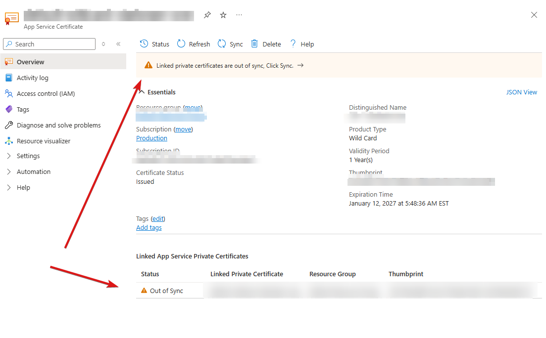

I am seeing a problem with my App Service Certificate that renewed last month (December 12th, 2025):
As you can see, the certificate is issued, but the linked certificates are out of sync. I have tried resyncing the certificates, and rekeying, but they do not sync. This has been happening for over a week now.

hossein jalilian • 13,365 Reputation points • Volunteer Moderator2026-01-22T21:27:54.9333333+00:00 Thanks for posting your question in the Microsoft Q&A forum.
The
Linked private certificates are out of syncbanner appears when the App Service Certificate has been renewed, but the Linked Private Certificate used by your Web Apps still references the old cert. This usually happens due to Key Vault access issues, binding conflicts, or a stale linked certificate object.check that Key Vault permissions allow the App Service identity to access the certificate, remove any conflicting bindings, and if needed, delete and recreate the linked private certificate from Key Vault. For persistent issues, creating a new ASC and re-binding your apps is the reliable solution. After fixing, run Sync again, and if the banner remains but apps use the new cert, it’s mostly cosmetic.

2026-01-22T21:31:34.8+00:00 Hi @hossein jalilian thank you for your reply. I can confirm that this is not cosmetic and I was unable to create a new certificate due to this syncing issue. If this was a permissions issue, shouldn't that be the error message? When I sync, it says it is successful (when it is not).

2026-01-22T22:08:00.8233333+00:00 Thanks for reaching us regarding your issue and sharing the screenshot and details—it's clear the certificate renewed successfully on December 12, 2025 (now expiring in January 2027), but the "Linked private certificates are out of sync" warning lingers despite your Sync and Rekey tries over the past week+.
This is a known post-renewal behavior: the new certificate version lands in Key Vault, but the App Service bindings don't always pick it up automatically (or even after manual Sync in some cases due to delays, permissions, or glitches).
This solution usually resolves the issue in most cases:- Check the Key Vault Go to the Key Vault linked to your ASC, then open the Certificates tab. Make sure the new expiration date appears and the status is "Enabled".
- Remove the outdated private certificate Navigate to App Service > TLS/SSL settings > Private Key Certificates (.pfx) and delete the old certificate (this only removes the link).
- Import the renewed certificate On the same TLS/SSL page, select Import Key Vault Certificate and choose the renewed certificate from your Key Vault.
- Update the bindings Go to TLS/SSL settings > Bindings, remove the old bindings, and add new ones using the updated certificate thumbprint.
Afterward, refresh your ASC blade. The yellow "Out of sync" warning should disappear, and the status will be healthy. Also, check Key Vault permissions for the Microsoft.Azure.CertificateRegistration principal, as incorrect permissions might cause issues.

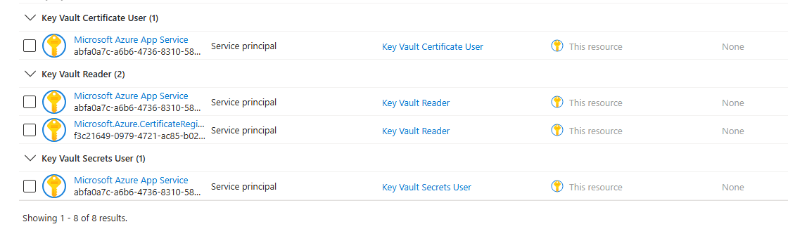

2026-01-28T22:57:39.3266667+00:00 Hi @Praneeth Maddali thank you for your reply. Please note that this Key Vault uses RBAC, not access policies, as you suggested. I again ask: why is the message stating that synchronization was successful when this clearly is not the case? Is this not a bug?

2026-01-30T18:01:00.5866667+00:00 Yes, I am referring to RBAC. Please add the necessary role assignments to the service principal, including the Microsoft.Azure.CertificateRegistration role and the Key Vault Reader role. Once these roles are assigned, perform a rekey and sync operation. After that, delete the old binding and re-add the certificate binding to update the information.

2026-01-30T18:07:00.2366667+00:00 Hi @Praneeth Maddali thank you for your reply but I am confused. You did not mention RBAC at all in your previous reply but are now saying that you are? I am unclear what you mean by "service principal". If you mean those GUIDs nothing returns when I enter them.

2026-01-30T18:16:06.9266667+00:00 To be sure @Praneeth Maddali this is what I see in RBAC and it's still not working after I re-sync:
