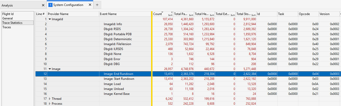

  2. Gary Nebbett 6,536 Reputation points
    2026-01-22T11:06:29.9266667+00:00
    Hello Alois,
    Below is a snapshot from the WPA Trace Statistics (looking at a merged trace).
    The event from the "Image" provider come from the "raw" ETL and the events from the ImageId provider are injected during the merge process.
    Your code is looking for what WPA calls "ImageId: FileVersion" events (opcode 64 / 0x40) and, if found, then injecting more events of the same type. However, since there are no "ImageId: FileVersion" events in the input ETL then none will be added to the output ETL. The "Image" provider Load and Rundown events are what you need to look for (they contain the file path of the image).
    Of the events fabricated and injected during a "merge", it is the "DbgId: RSDS" (opcode 36 / 0x24) events that are most useful for symbol loading, since they contain PDB signature and age information.
