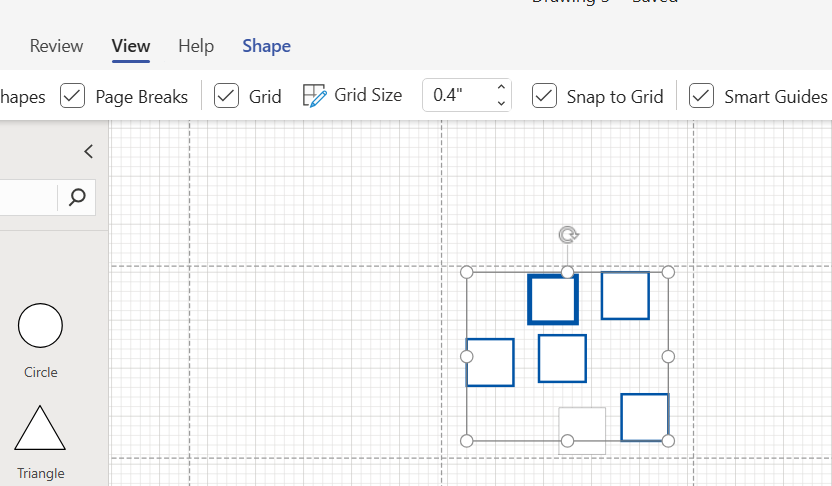

I can't find a place to fit my drawing to page size and I can't seem to find the options in design that would allow my drawing to not automatically populate the bottom right corner of a page instead of the middle. I can drag the full drawing as an object, but I still have to adjust it every time. Is there an easier way to do this?
I have already tried to look it up, and nearly everything is telling me that it is in the design tab, and I have only page sizes in my design tab and nothing about "Fit to Size" or any other way to reorient center on my drawing. I can't even seem to do a custom size for margins. Any help would be appreciated

    Thank you for posting your question in the Microsoft Q&A forum. I understand that you are trying to adjust your Visio diagram so that it fits cleanly on the page and remains centered, but the options you expect, such as Fit to Page, Fit to Drawing, or margin controls, do not appear in the Design tab. You also mentioned that your diagram consistently shifts to the bottom‑right corner instead of staying centered.
    Based on the behavior you described, it appears you are working in Visio for the Web. This is important to note because the web version provides only basic page‑size controls. Features such as:
    Fit to Page / Fit to Drawing
    Automatic centering
    Custom margins
    Advanced Page Setup settings
    are only available in the Visio Desktop application. Visio for the Web has limited layout, printing, and scaling capabilities, which explains why the expected tools do not appear in your interface.
    Additionally, the off‑center behavior you are seeing often results from the shape “bounding box” extending beyond the visible area, sometimes due to connectors, hidden text boxes, or other elements slightly outside the main diagram. Normally, desktop‑only tools (Fit to Drawing, ShapeSheet margin controls) correct this, but they are not available in the web version.
    Although the web version is limited, I suggest the 2 options below:
    Option 1/ Use Page Break View for easier manual alignment
    Since full Fit‑to‑Page features are not available online, I recommend enabling page boundaries to clearly see where your diagram sits on the page:
    Go to: View > check Page Breaks
    This will show you the actual printable area, making it much easier to manually adjust your diagram so it sits correctly within the page limits.
