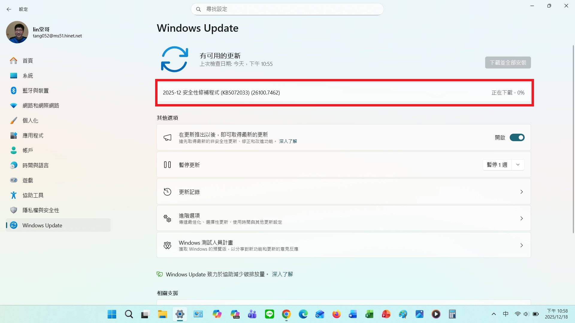

2025-12 Security Update (KB5072033) (26200.7462) will not install. Any suggestions?
Jon Buuck 545 Reputation points
2025-12-09T22:22:56.5733333+00:00
I've downloaded 2025-12 Security Update (KB5072033) (26200.7462) three times, and each time it fails to install. Any suggestions or is this a problem with the update. My computer is a week old.
