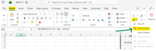

    User's image User's image
    • Alternatively, use Home -> Clear -> Clear Formats on the output cells (if you do not need other formatting on this sheet).
