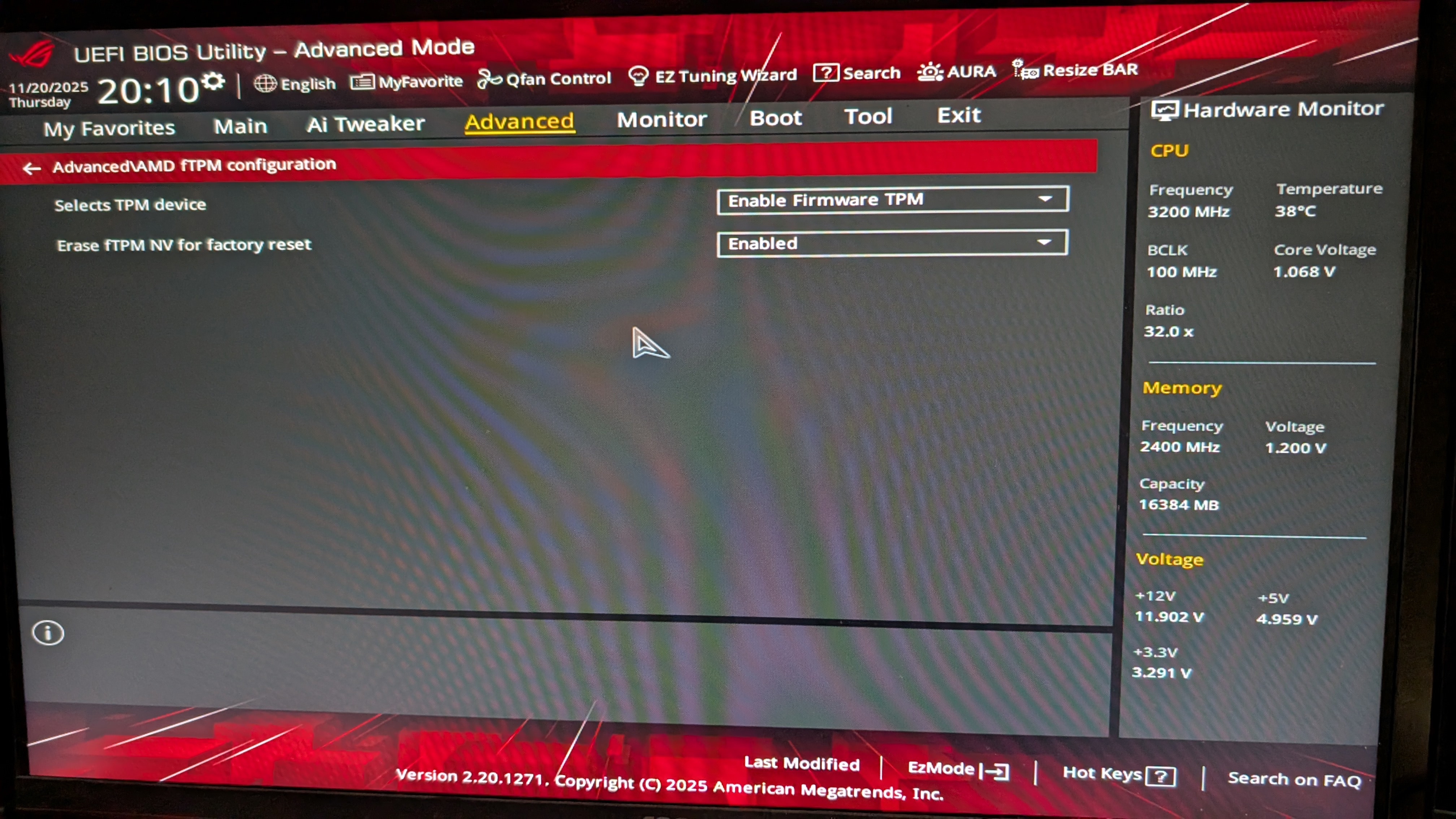

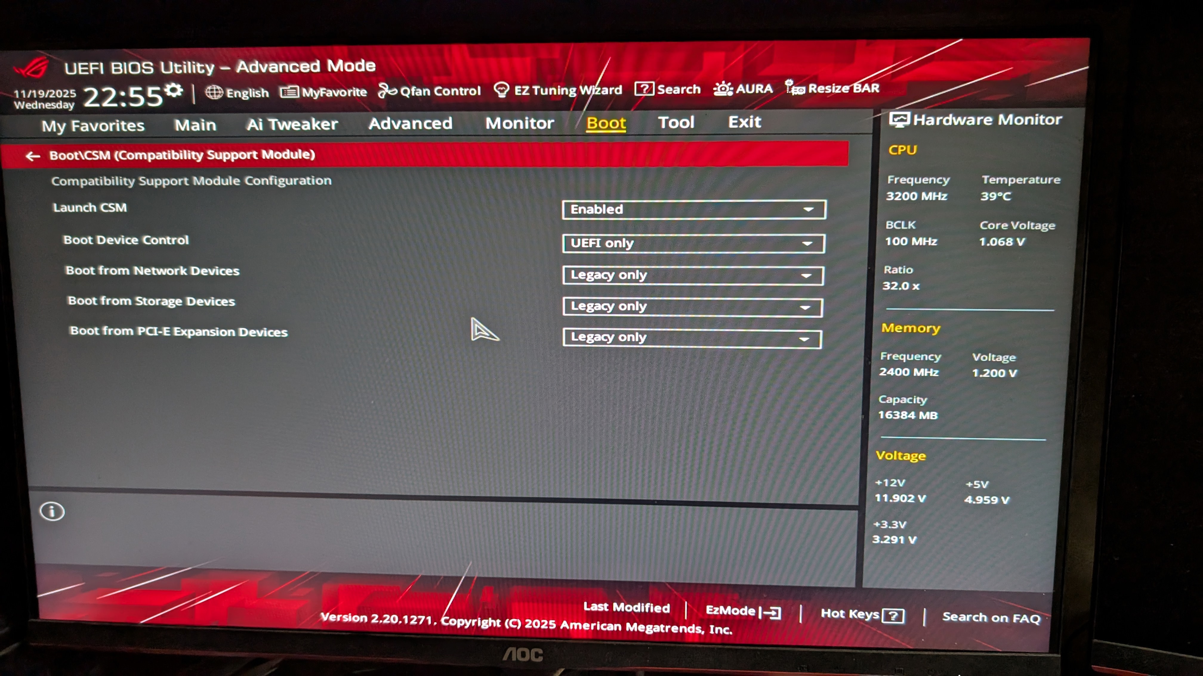

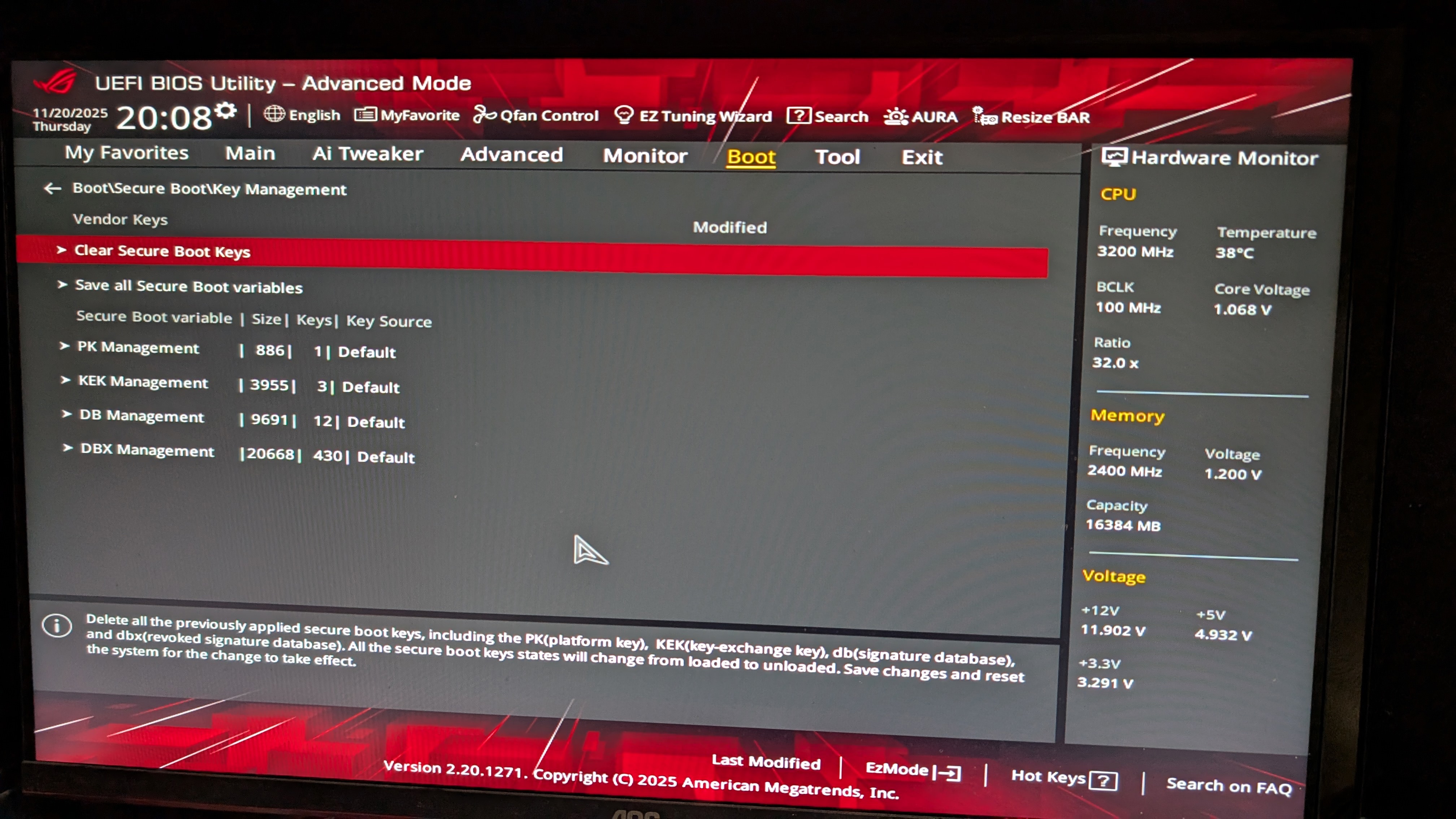

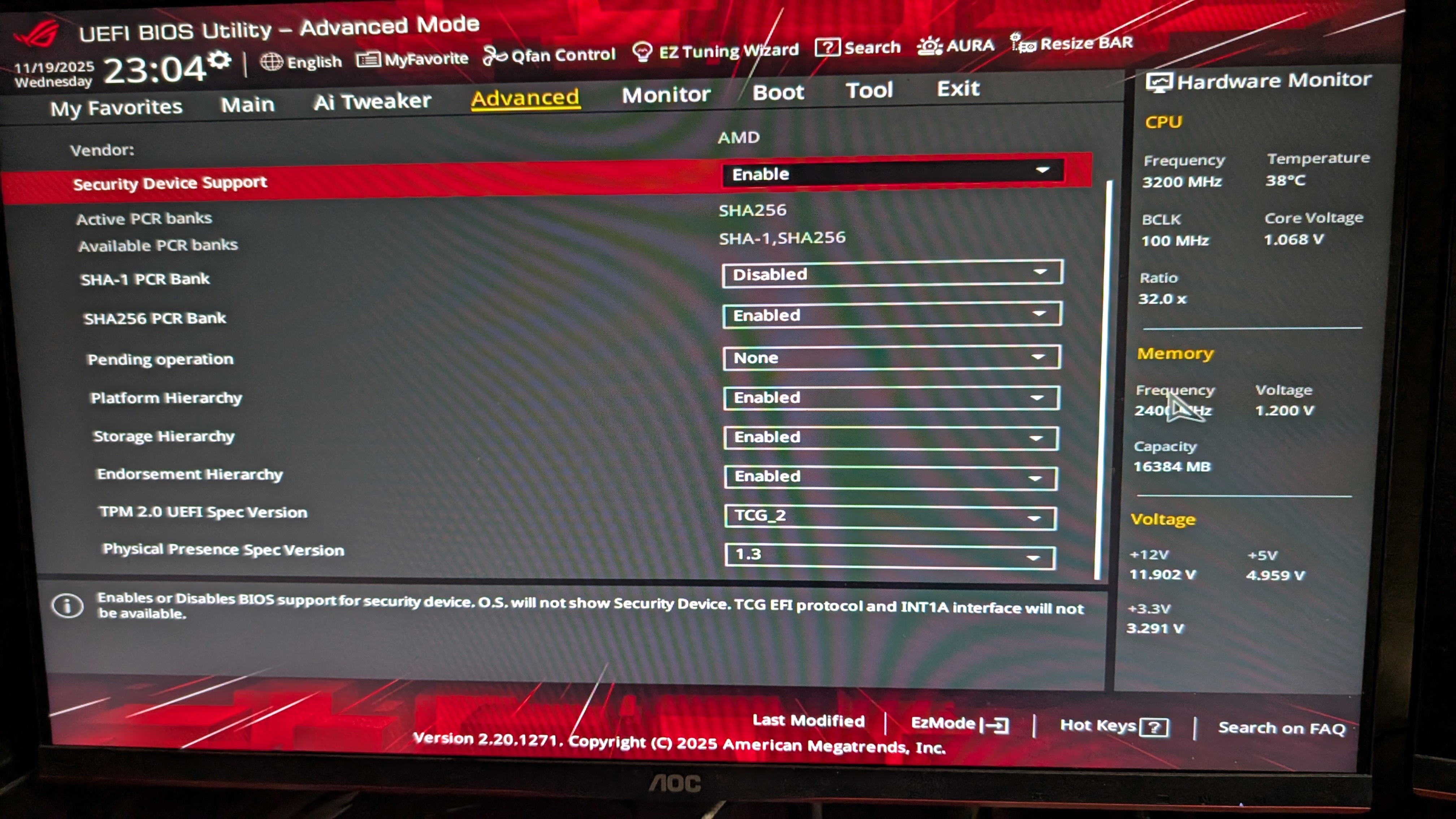

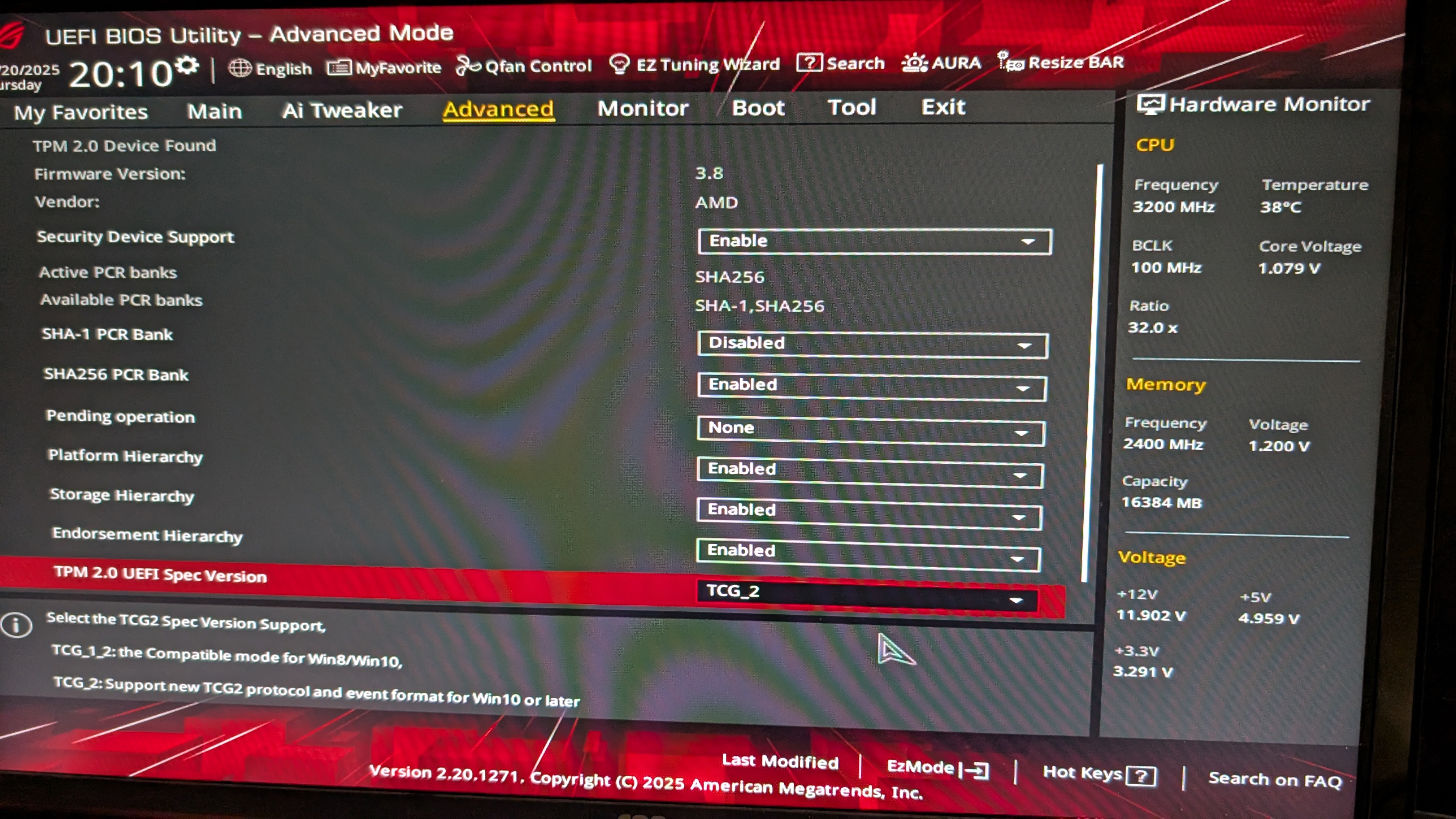

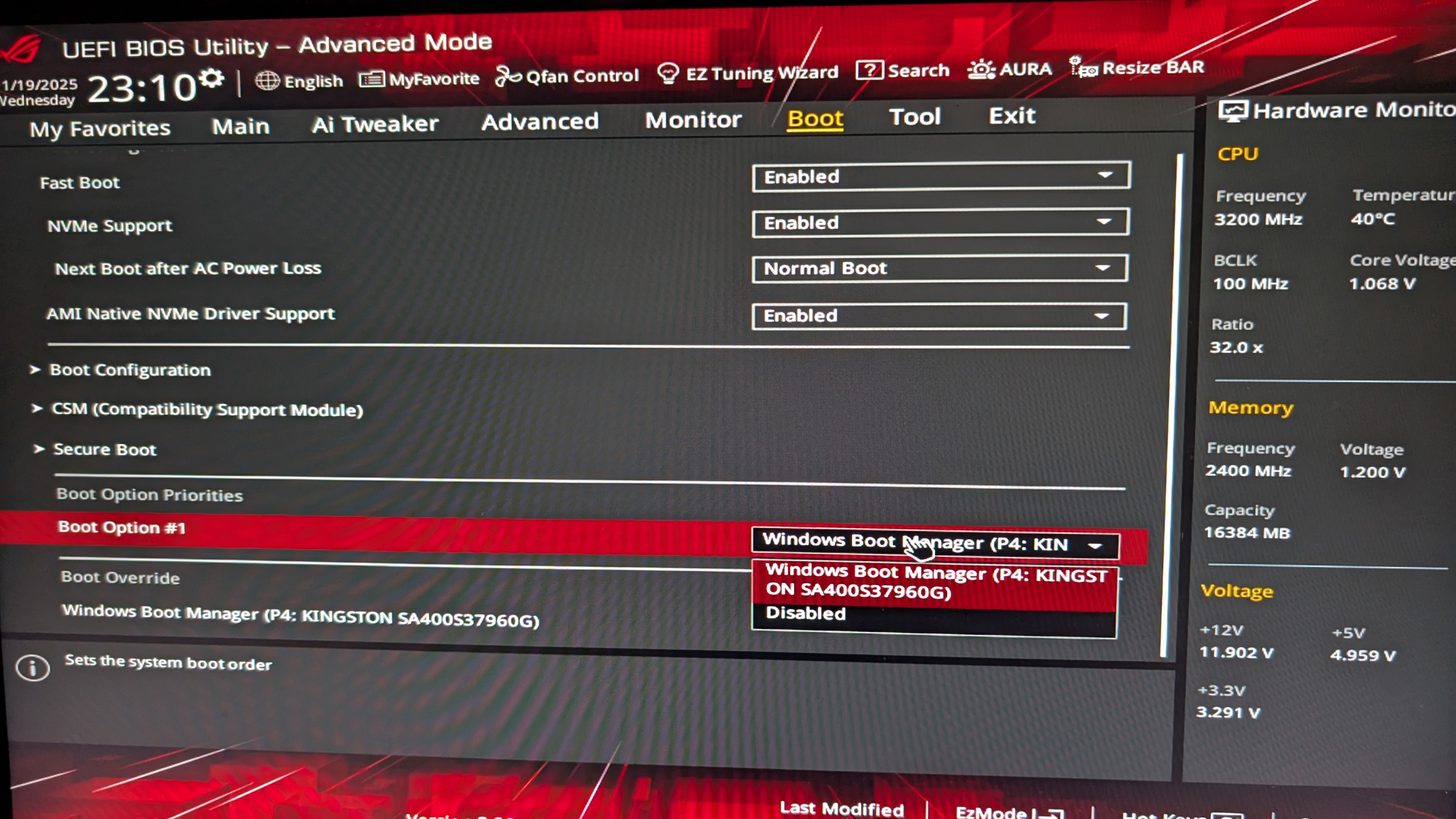

I've recently been encountering an issue with my Win11 install and I'm out of options for personal troubleshooting; before I detail the problem I would like to state upfront that I have seen several people with similar issues and in following their proposed fixes I have already:
Completely formatted my SSDs and even changed which once I (re)installed Windows on
Cleared my TPM keys in my UEFI settings
Flashed my BIOS and cleared my CMOS
With that out of the way, the specific problem is that whenever I try to boot into my Windows 11 install while Secure Boot is enabled, I run into the error screen and my only recourse is to reboot completely and disable my TPM on the hardware level from my UEFI settings. Once that has been done, Windows boots and even operates completely fine, with zero issues whatsoever. My problems are largely that if I encounter something I do require Secure Boot for (Battlefield 6, for instance, requires it as do a slowly increasing number of other games) my setup is completely unable to allow for this. I have seen a lot of suggestions about reinstalling the TPM firmware through Windows' onboard device manager, but this is also impossible as the only way I can boot into Windows (and therefore access the device manager) is to have it disabled, which means it does not show up as a recognizeable device. Similarly, I am locked out of Safe Mode as far as I can tell for similar reasons. If anyone else has encountered this issue I would love to hear any sort of help that can be offered. Thank you very much for reading!

    Power the PC off. Enter UEFI setup and set Boot or CSM to UEFI only. Make sure Secure Boot is enabled and the mode is Standard or Factory, not Custom. Use the option that resets Secure Boot to factory defaults. Enable TPM 2.0 in firmware as Intel PTT or AMD fTPM. Save changes, keep Secure Boot on, and boot from a Windows 11 USB installer.

    If you still see the same error, return to UEFI and verify that SATA or NVMe controller modes have not been left on a legacy or RAID-only setting. With a clean Windows 11 install, AHCI for SATA and pure NVMe for M.2 are typically the most compatible when Secure Boot and TPM are on.
