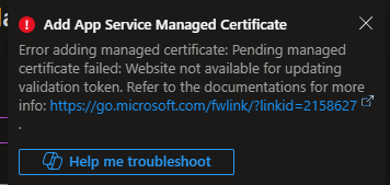

Failed to create App Service Managed Certificate: Pending managed certificate failed: Website not available for updating validation token
I am attempting to add a managed app service certificate to a Blazor windows webassembly application and getting this error.

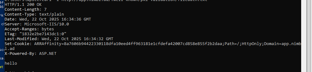

Dan Piccot • 0 Reputation points
2025-10-22T17:04:47.5233333+00:00 The website is only a single index.html file now to prevent any SPA redirects from messing things up, so there isn't a web.config file at all now and no blazor redirects in place.
I was able to create the dummy file and got a 200 OK using
curl -i http://app.nimbl.ad/.well-known/pki-validation/fileauth.txt
Http-Only is confirmed off.

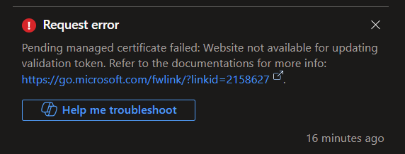

Lastly, running the CLI command results in a similar error to the one in the UI
Bad Request({"Code":"BadRequest","Message":"Pending managed certificate failed: Website not available for updating validation token. Refer to the documentations for more info: https://go.microsoft.com/fwlink/?linkid=2158627.","Target":null,"Details":[{"Message":"Pending managed certificate failed: Website not available for updating validation token. Refer to the documentations for more info: https://go.microsoft.com/fwlink/?linkid=2158627."},{"Code":"BadRequest"},{"ErrorEntity":{"Code":"BadRequest","Message":"Pending managed certificate failed: Website not available for updating validation token. Refer to the documentations for more info: https://go.microsoft.com/fwlink/?linkid=2158627."}}],"Innererror":null})

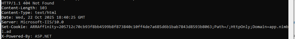

2025-10-22T18:41:17.2233333+00:00 1)Check the File System for Token Placement:
- Renamed and checked the folder during creation, no file was ever created. Settings also checked and confirmed correct like you mentioned.
