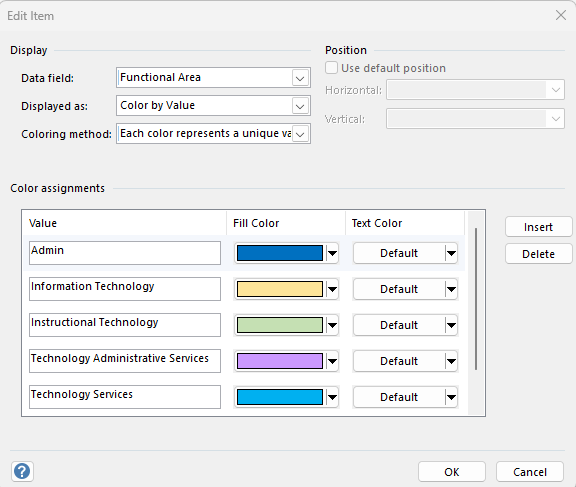

  2. The column titles in the Excel table, created automatically by the add-in, are Employee ID, Name, Title, Manager ID and Role Type. I am not able to edit these and get an error if I try. I added another column called Functional Area (which is esentially the sub-department each employee belongs to). This extra column does show in Visio under Shape Data when you click on an employee. What I would like to do, if possible, is to have my org chart be separated by functional area. I read that you can use Shapes to separate things, but I cannot figure out how to use shapes when editing the add-in in Visio. Is there a way to group by an added column in Shape Data?

Grouping by custom columns like “Functional Area” is not natively supported in the web app. As a workaround:
  • Manually drag shapes into containers labeled by department.
  • Use the Insert > Container option in Visio to visually separate groups.
