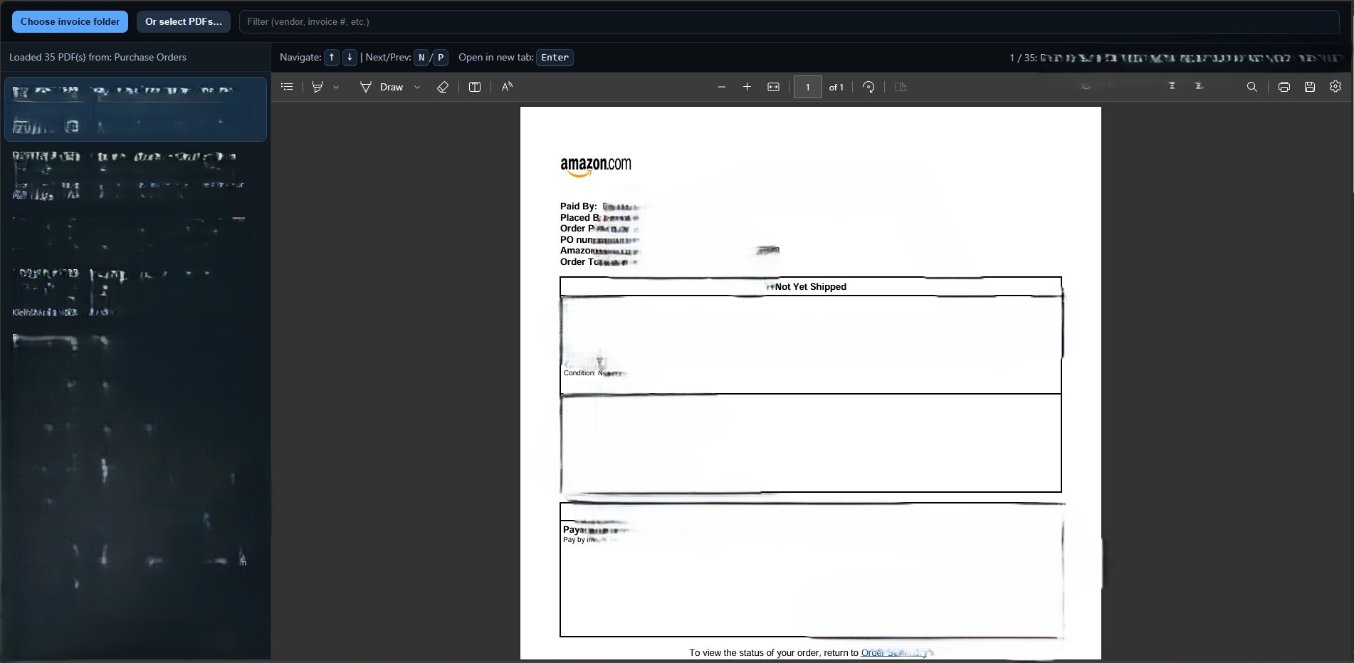

I know this post has been stale for a couple of months but wanted to offer a potential solution outside of Windows Explorer to anyone else who would be interested.
I had Copilot help me write a small PDF "Previewer" using HTML so that large volumes of PDFs can be previewed very quickly. This was at the request of our Accounts Payable department, who used the Previewer to quickly check the names, sales tax, and other identifying information from our scanned documents with ambiguous file names so they could be re-named and sorted appropriately. For anyone who would like to try it out download the PDF.txt file and change the filetype to .html. From there, right click it and open it in your favorite browser: PDF.txt
