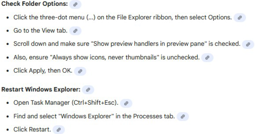

Here is a simple solution that worked for me -
in the file explorer, just disable this check box as shown in the image, this simply worked for me
(This happened on windows 10 as well!)

Open File Explorer.
Select View (top menu) → Options → Change folder and search options.
Go to the View tab.
Ensure the following:
Preview pane is enabled
In File Explorer: View → Show → Preview pane
**“Always show icons, never thumbnails”** is **unchecked**
Click **Apply** and **OK**.
Close File Explorer and reopen it.

To restart Windows Explorer, go to Task Manager, find an instance of Windows Explorer, right click on it, then click on restart.
that option just stop preview from working at all for me, at least on win 11
