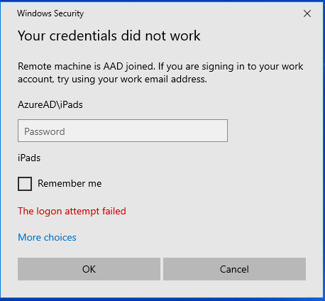

When I try to RDP to PC it is asking for User and Password and can not pass this screen. I'm entering my AzureAD\iPads user password.
This is what I get.
I can not login to RDP.

I understand that You’re trying to RDP into a Windows 11 Pro machine that is Entra joined, but the credentials fail even though you can log in locally with a PIN.
- The PC is connected to Entra ID
- You have AzureAD\iPads in the Remote Desktop Users group.
- RDP prompts for username/password, not PIN.
- Error says: Remote machine is AAD joined. Try using your work email address
As per the screenshot, we might suspect that this might happen due to the MFA related error.
If you configure a legacy per-user Enabled/Enforced Microsoft Entra multifactor authentication setting and you see the error, you can resolve the problem by removing the per-user MFA setting. For more information, see the article Enable per-user Microsoft Entra multifactor authentication to secure sign-in events.
Kindly refer the below document for the reference: https://learn.microsoft.com/en-us/entra/identity/devices/howto-vm-sign-in-azure-ad-windows?pivots=identity-extension-vm#mfa-sign-in-method-required
