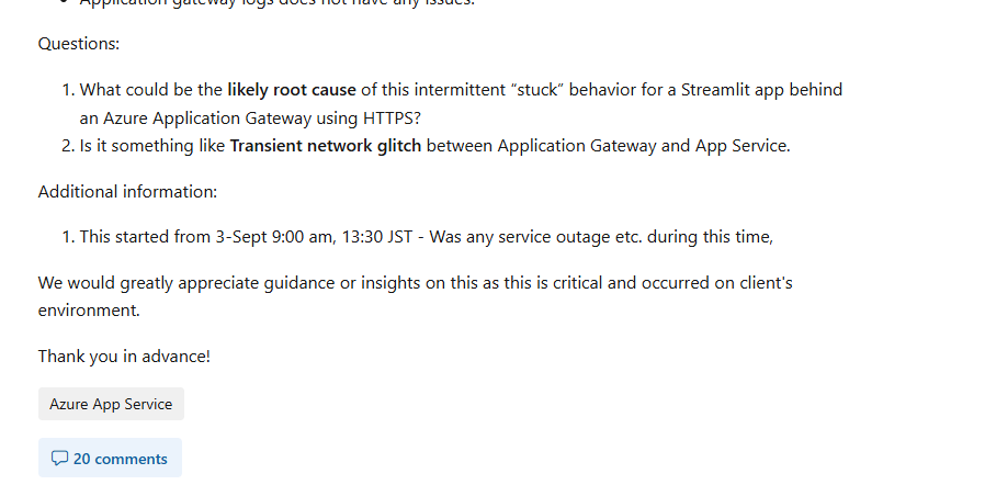

Hello All,
We recently experienced an issue with our Streamlit application hosted on Azure App Service (B3:1)[Linux] behind an Application Gateway, it was working smoothly.
Although the problem is currently resolved after restarting the App Service, we would like to understand the possible root causes and recommendations to prevent it in the future.
Scenario:
- Architecture:
- Client → HTTPS custom domain → Application Gateway → Azure App Service → Streamlit app
- Symptom:
- While accessing the app via the HTTPS domain, the Streamlit page did not fully load.
- The issue occurred intermittently and was resolved immediately after restarting the App Service.
Observations:
- CPU and memory usage on the App Service were normal during the incident.
- App Service is configured with “Always On”, setting as ON so it does not go idle.
- Restarting the App Service immediately resolves the problem.
- Application Logs did not show any critical errors during the issue.
- No network issue at client's browser side.
- Application gateway logs does not have any issues.
Questions:
- What could be the likely root cause of this intermittent “stuck” behavior for a Streamlit app behind an Azure Application Gateway using HTTPS?
- Is it something like Transient network glitch between Application Gateway and App Service.
Additional information:
- This started from 3-Sept 9:00 am, 13:30 JST - Was any service outage etc. during this time,
We would greatly appreciate guidance or insights on this as this is critical and occurred on client's environment.
Thank you in advance!

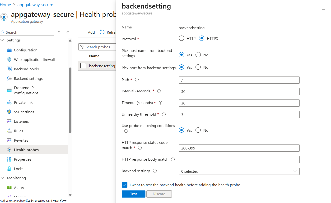

In addition, make sure health probes are properly enabled and configured on the Azure Application Gateway for your App Service. The probes continuously monitor the health of your App Service instances. If an instance stops responding (for example, due to a transient glitch or resource exhaustion), the gateway marks it as unhealthy and automatically routes traffic only to the healthy instances. This prevents users from being sent to a “stuck” instance and reduces the likelihood of intermittent failures.

Q#2 : Regarding "Health probes are properly enabled and configured" --> With single app service, we have below configuration (PFB screenshot) , I hope this is properly configurated ?
Let us know, if any changes/recommendation if we use only single app service. -
2025-09-16T10:02:13.1966667+00:00 Yes, it's look correct, Dcm
Kindly ensure that the probe path returns a healthy HTTP 200 response.

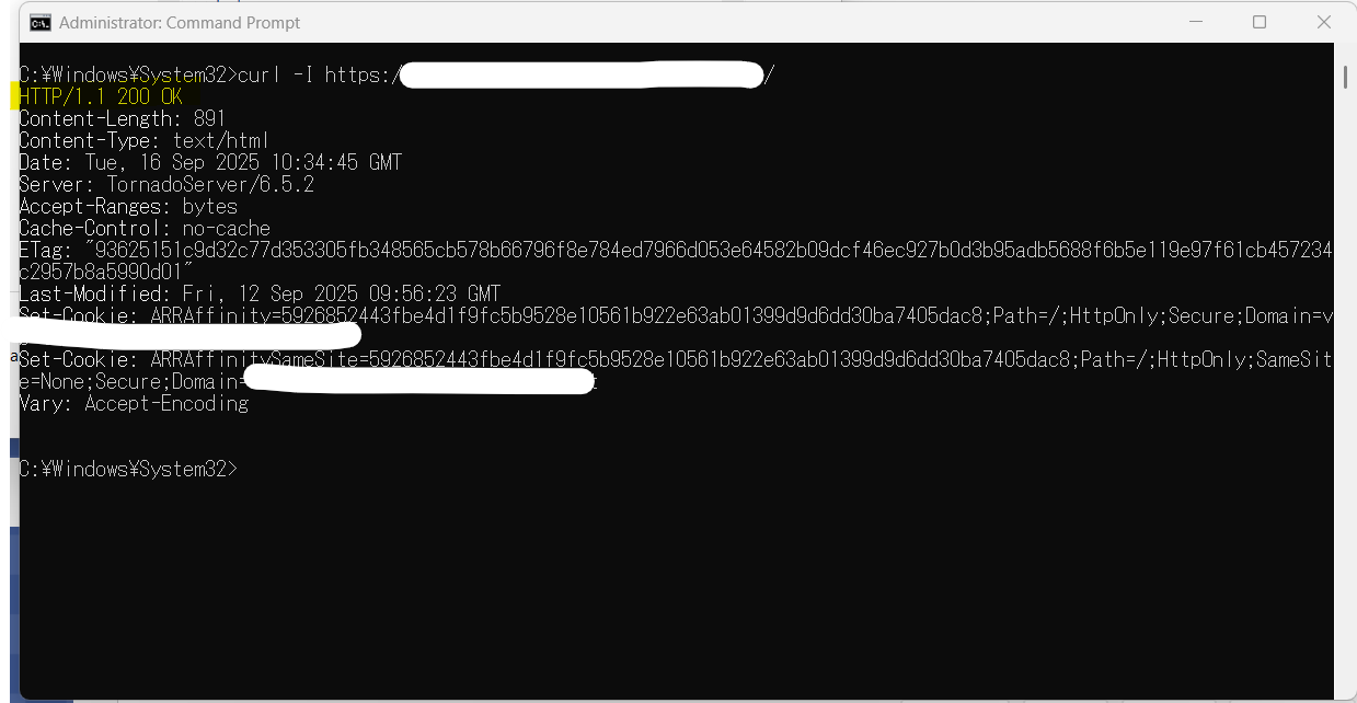

Dcm • 20 Reputation points
2025-09-16T10:36:40.98+00:00 Hi Vimal Lalani
Thank you for response.
We checked HTTP 200 as below
I hope this is fine ?

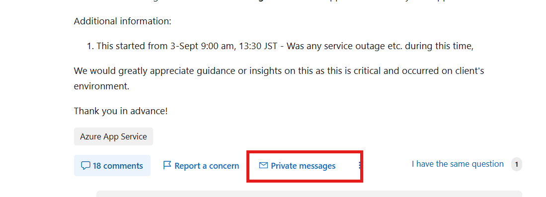

--> Hi Vimal Lalani, Can you tell me, how to share this on private message as this is my new id, can't find any option.
2025-11-05T02:37:31.94+00:00 Hi @Bipin Kadam ,
At the top of this thread, you can find a private message like the one shown in the image. I will send you the message, and you can reply to it.
