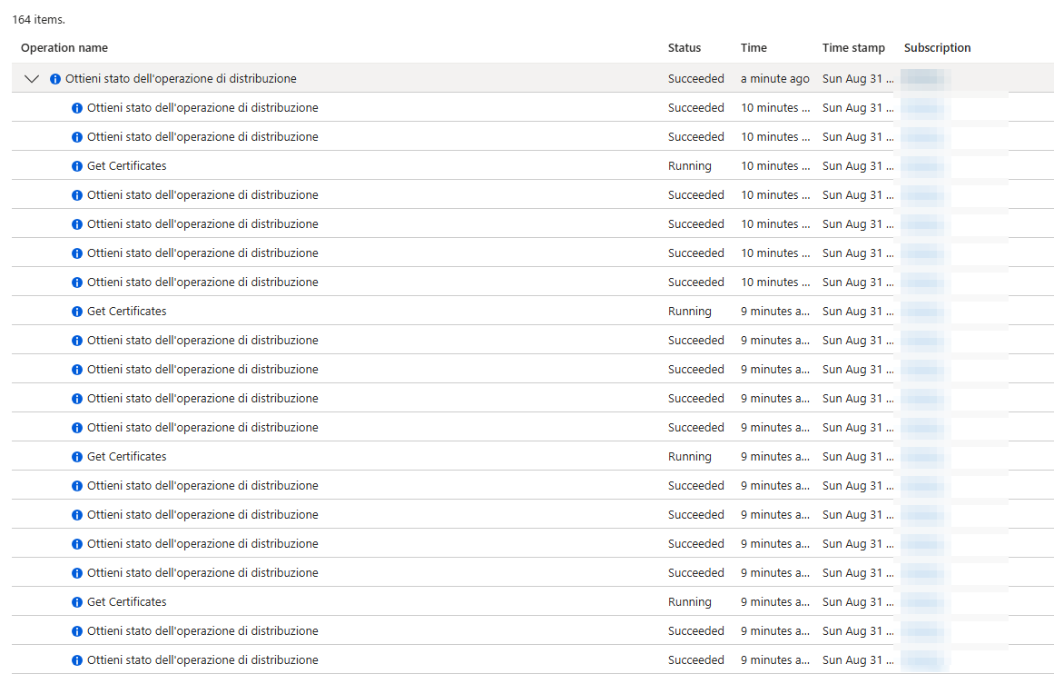

I am attempting to deploy an App Service via Bicep template and am running into what appears to be serious problems with Azure Resource Manager.
To start, I have 3 App Services that all run the same template, and two of them succeed without problems. The 3rd one hangs on a Microsoft.Web/certificates task, and when I view the Related Events, I can see what appears to be a recursive call to get the certificate:
Notice also the use of... Italian? Not exactly getting the warm n' fuzzies here.
These operations will continue until it times out at about an hour later.

2025-09-01T06:13:35.6233333+00:00 Hi @Bhargavi Naragani thank you for the reply, but that does not seem to be the same issue. There are no errors thrown, but the operation appears to repeat forever with messages emitted in Italian and Japanese. I provided the correlation ID for further investigation.

2025-09-01T08:07:05.5933333+00:00 Thank you for that @Bhargavi Naragani . Why is Azure displaying Italian and Japanese messages instead of stating the actual problem? This seems like an obvious defect. Additionally, I already have my deployments separated as recommended so that the two-phase approach occurs. Are you saying you have investigated the correlation ID and have determined this is the problem? Thank you for your continued assistance.

the repeated Italian/Japanese messages in the Activity Log don’t provide much clarity and understandably feel like a defect. These localized strings are coming from Azure’s backend telemetry systems, and while they aren’t harmful themselves, I agree that they obscure the real root cause instead of surfacing a more actionable message.
