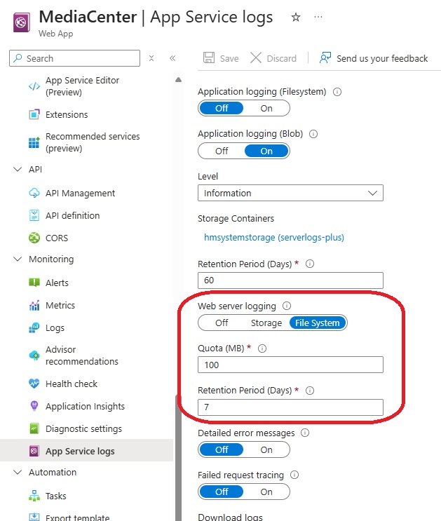

I have since restarted both App Services, I also have attempted to "turn off" HTTP logging and then turning it back on. Neither caused Web Logs to be created again.

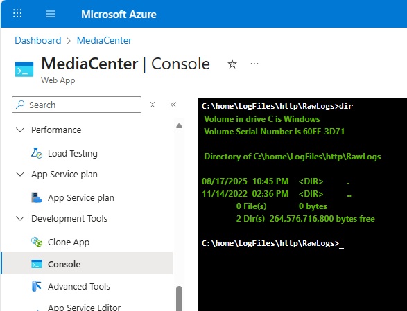

Permissions are not an issue, as these files are/were being created on the App Services built-in "local" disk.
I'm attaching screen shots of the configuration screen, as well as the directory display.

I'm not sure if you are unable to see my previous response INCLUDING the SCREEN CAPTURES, or if you're just pasting in a boilerplate response?
To your 3 points:
to 1: The screen capture clearly shows that HTTP logging is enabled - where ELSE would you like me to check SPECIFICALLY?
to 2: The screen capture also shows that retention policy allows for 7 days.
So there is no reason why on any given day, the most recent logs for that day would not be present (as they used to be for the past 2 years)to 3: We originally noticed the absence of logs because our usual FTP process was no longer yielding data. Only then did we log into the console/portal to confirm that the data was indeed missing (thus ruling out any possible FTP-specific issues)

The problem was NOT that older logs were being deleted on 08/15 (because of size). On 08/15, the logging stopped and no more entries were written to the log files.
To rule out a potential quota limit, we waited a few days - and when logging never resumed, WE manually deleted the existing log files from the file system. However, even after with the logging directory now empty (as you saw in my previous screen captures), and even after restarting the app service, and even after resetting the settings, logging never resumed.
