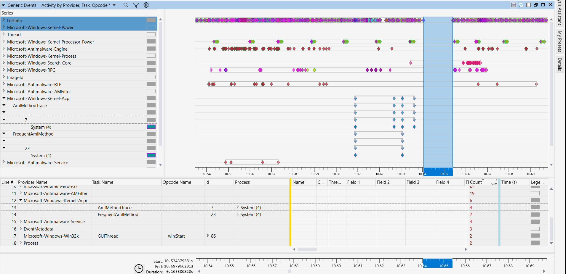

In any case, here's another trace, and the timer resolution trace looks VERY different to the previous one. Why is Chrome now requesting an 8ms clock? And why does it seem to be saying that the "actual" system timer is a constant 15.6ms now? The command line Clockres utility says the "current" resolution is 1ms - not 15.6. This trace was recorded using battery power - maybe that has something to do with it.
I owe you an apology Gary - I have no idea what's going on with the timer. Sorry. 🤣https://drive.google.com/file/d/1_tOMtke9FEhhjDUyT3nMx1iOw1Lvf18q/view?usp=sharing
Refer ~48.1s for the familiar ~14ms interruption of timer ticks.Should I crosspost in the systems internals forum?
Gary Nebbett • 6,536 Reputation points2025-07-29T07:23:28.45+00:00 Hello Greg,
dynamic tick, coalescable timers, multimedia timers, waitable timers (plus/minus flag CREATE_WAITABLE_TIMER_HIGH_RESOLUTION), serialized timer expiration, etc. all combine to make analysis of timer behaviour complicated.
I am currently working on finding the best set of trace providers, keywords, levels and stack traces that give me the best insight into what is happening in any particular case.
Cross posting to relevant forums can do no harm; it is my impression that the "Sysinternals" forum is for users of the tools rather than developers - its summary says "Advanced system utilities to manage, troubleshoot, and diagnose Windows and Linux systems and applications."
Gary

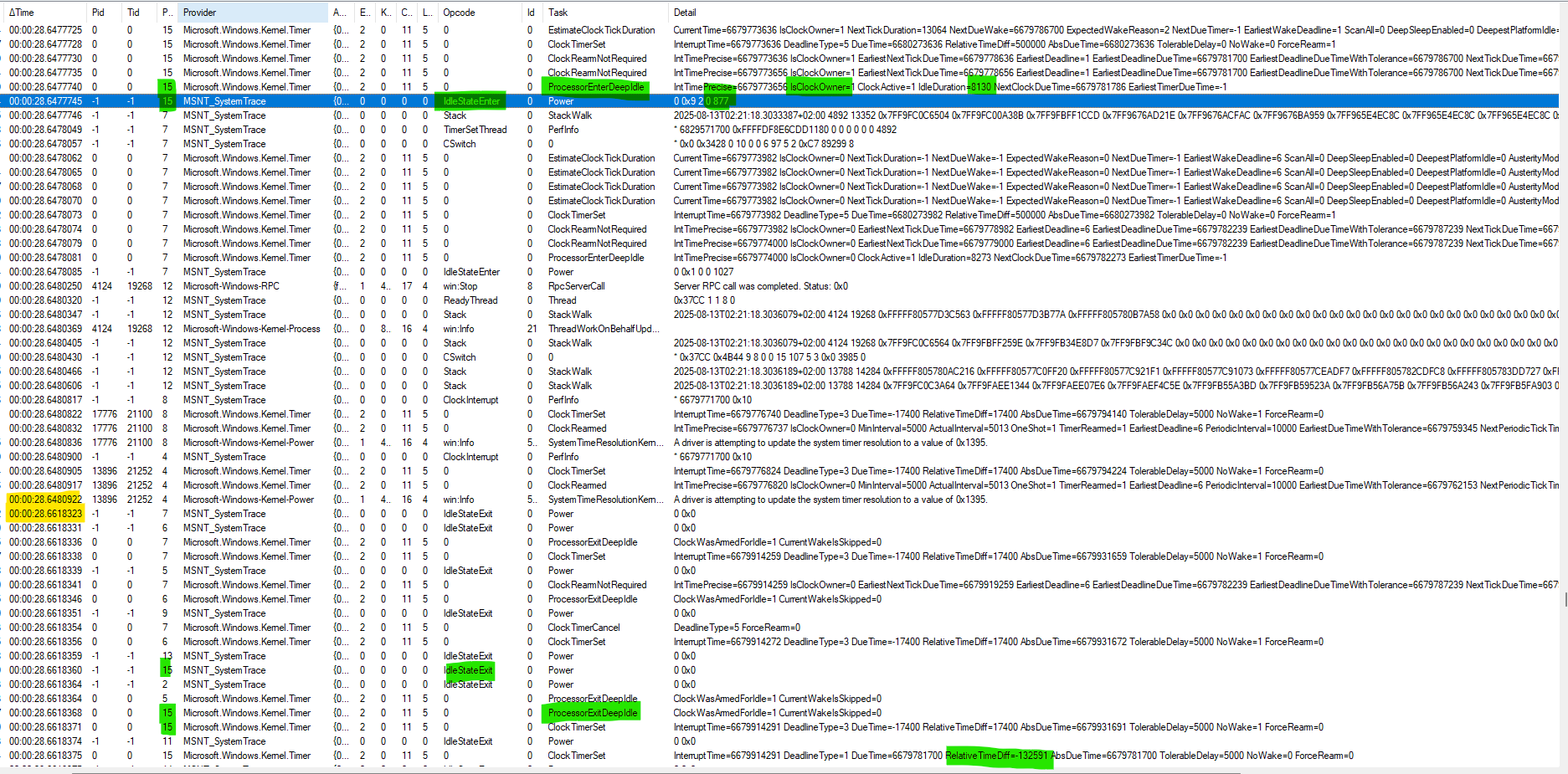

Gary Nebbett • 6,536 Reputation points2025-07-29T11:04:42.6033333+00:00 Hello Greg,
This is the type of thing that I am looking at: I am using CreateWaitableTimerEx to create a timer with flag CREATE_WAITABLE_TIMER_HIGH_RESOLUTION. I send a UDP packet when the timer runs to make that time easily findable in the trace. Here is one example where a timer with interval 5 ms first runs after 6.2 ms.
My timer with 5 ms period (50,000 100 ns ticks) triggers (opcode ExpireKTimer2) and thread 0x20AC (decimal 8364) is made ready; 0.5 ms later the thread begins to run on processor 2 (the previous thread on that processor was 0 (i.e. idle)). So 0.5 ms of the 1.2 ms delay was due to thread scheduling - possible the power/idle state of processor 2; I will need to add some more trace providers to track that behaviour.
Gary

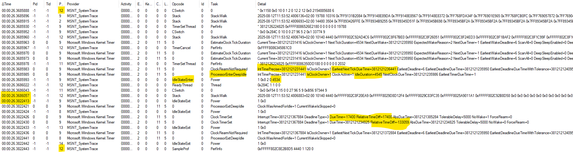

A detailed view of a section (around the 48.1 s mark) of your second trace looks like this:
The column marked in green is the processor number; at the bottom of the green section, most processors are in the C3 (Sleep) state - just 7 and 13 (the clock owner) are still running.
In the yellow section, processor 13 enters the sleep state (leaving only processor 7 running) and expects to be woken in 14986 ticks (14.986 ms).
After 13.8 ms, the processors start waking and the next clock tick occurs.

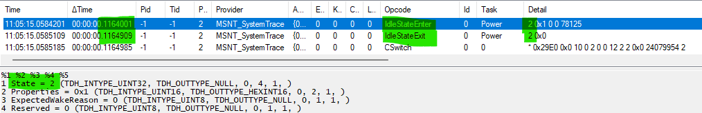

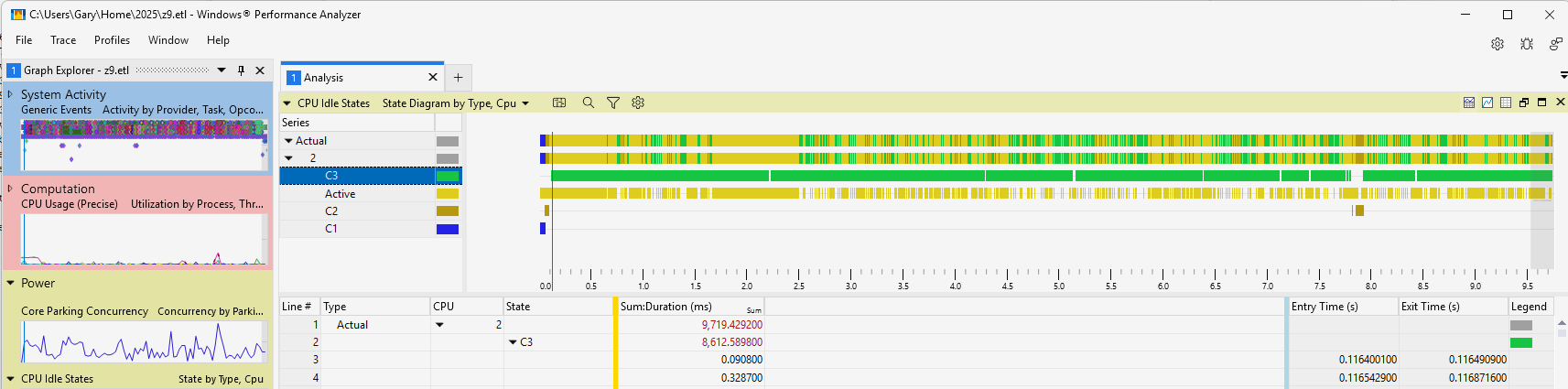

Anyway, I've attached a new WPA screen grab for your perusal, along with the profile file I'm using, and which I'd like to be able to run with a much smaller circular buffer, to make it easier to share ETL files. This profile was created with the following command:
wpr -exportprofile cpu+power cpu_power.wprp
Referring to the screen grab, the test ran for a whopping 5.4 hours before what appears to be the same kind of idling event occurred. It's not apparent from the image, but upon closer inspection of the CPU Idle States graph, CPU 8 appears to be the only core at Idle state 0 (fully active?) during the idle period. For this test, I forced both my Powershell script and the ASIO driver test utility to use CPU 8. (I thought it would make sense for both to be on the same core, and I chose #8 at random)
Regardless of what kind of power plan is active, does it actually make sense to EVER allow CPU 0 to idle for this long (~14ms), given that it's the "main" core, servicing most of the interrupts etc?
Profile file: cpu_power_wprp.txt -
Gary Nebbett • 6,536 Reputation points2025-08-04T16:31:05.0733333+00:00 Hello Greg,
Here is some immediate feedback - I might be able to follow-up with some more information/ideas.
I think that idle state 1 (which I interpret to mean C1) just means that the processor has executed the HLT instruction - the processor is "idle" (waiting for an interrupt) but not otherwise in a reduced power state.
Under the menu point Trace -> System Configuration, tab Trace Statistics, one can see how much space each trace provider is using. I just made a very short trace using the CPU + Power profile and this is what that tab shows:
The vast majority of the space is used by information that I consider totally irrelevant for your purposes (DotNET information, only used (as far as I known) in this case to give more meaningful stack traces (IL method names rather than JIT code addresses)).
File operations also seem irrelevant and the ImageId events are only needed for detailed stack traces (routine names rather than just "module" information).
Some large items in the trace file are "genuine" events (created while the trace is still running), such as the DotNET events; some other events (e.g. the ImageId events) are "fabricated" by WPR after the trace has stopped.
If you want to trace for hours then I would carefully consider what needs to be included in the resulting trace file; I would also dispense with most of the "CaptureState Providers on Save" elements since, in the circular capture mode (Memory vs. File), these can cause too much history to be ejected from the buffer(s) when the trace is stopped.

2025-08-11T04:14:59.97+00:00 Gary,
I added that timer category that you suggested, but I don't see it in the traces. I've attached my profile. wpr_wprp.txt -
Gary Nebbett • 6,536 Reputation points2025-08-12T06:38:28.96+00:00 Hello Greg,
I used your profile to create a trace and the Microsoft.Windows.Kernel.Timer events were present:
Gary

Gary Nebbett • 6,536 Reputation points2025-08-13T09:57:11.24+00:00 Hello Greg,
Looking at the "on battery" trace:
The events indicate that processor 9 (the clock owner) is planning to enter the C2 (clock stop) state for 0.4545 ms and that other threads are active on other processors (processor 12 can be seen in the trace extract).
Rather than being in a low power mode for just 0.45 ms, processor 9 is in a low power state for 13.6 ms; when it resumes activity, it notices that some timers are badly overdue.
There are no trace events during the 13.6 ms pause of processor 9 although threads are active on other processors (I did not check the state of all 16 processors); statistically, I would expect to see some events (e.g. CSwitch) for the active processors.
It appears to me that the whole CPU has "paused" and it looks as though Windows did not intend/instigate this behaviour.

Gary Nebbett • 6,536 Reputation points2025-08-13T12:30:39.2033333+00:00 Hello Greg,
Here is an extract from the "on AC power" trace:
Essentially, the same as the on battery trace. The clock owner enters the C2 state, expecting to be idle for 0.8 ms. In this example, events from other processors are logged for a few microseconds after that before a 13 ms period of no activity begins. When the clock owner resumes, it notices that there are badly delayed timer expirations to process.
On my PC, I can detect jitter in CREATE_WAITABLE_TIMER_HIGH_RESOLUTION timer expirations, but it does not match the pattern of "complete" inactivity; I believe that the resolution of these CREATE_WAITABLE_TIMER_HIGH_RESOLUTION timer expirations is reduced when the process is running in the background and that is what I am probably observing in my tests (I am doing other things on the PC while the test runs).
Gary

Gary Nebbett • 6,536 Reputation points2025-08-14T09:38:09.6066667+00:00 Hello Greg,
One can arrange for WPA to show idle state events like this:
One can then use the exact entry and exit times to find the events that WPA used.
For C1, the entry and exit events are IdleStateEnter state 0 and IdleStateExit state 0.
For Active, the entry and exit events are IdleStateExit state <n> and IdleStateEnter state <n>.
For C3, the entry and exit events are IdleStateEnter state 2 and IdleStateExit state 2:
Gary

2026-05-03T03:39:44.9933333+00:00 Please refer to the attached WPA screen, which shows ACPI activity just before the 13ms stall.
Gary Nebbett • 6,536 Reputation points2026-05-03T11:08:59.21+00:00 Hello Greg,
The choice of "providers" is not what I would choose: the Antimalware, RPC and Search providers don't seem relevant and some useful "Power" events (e.g. Keywords "Power" and "IdleStates") don't seem to be present.
The ACPI events with ID 7 normally come in start/stop pairs - the graph seems to suggest that ACPI activity occurred before the 13ms window (where no events occur) rather than spanning the window.
Gary
