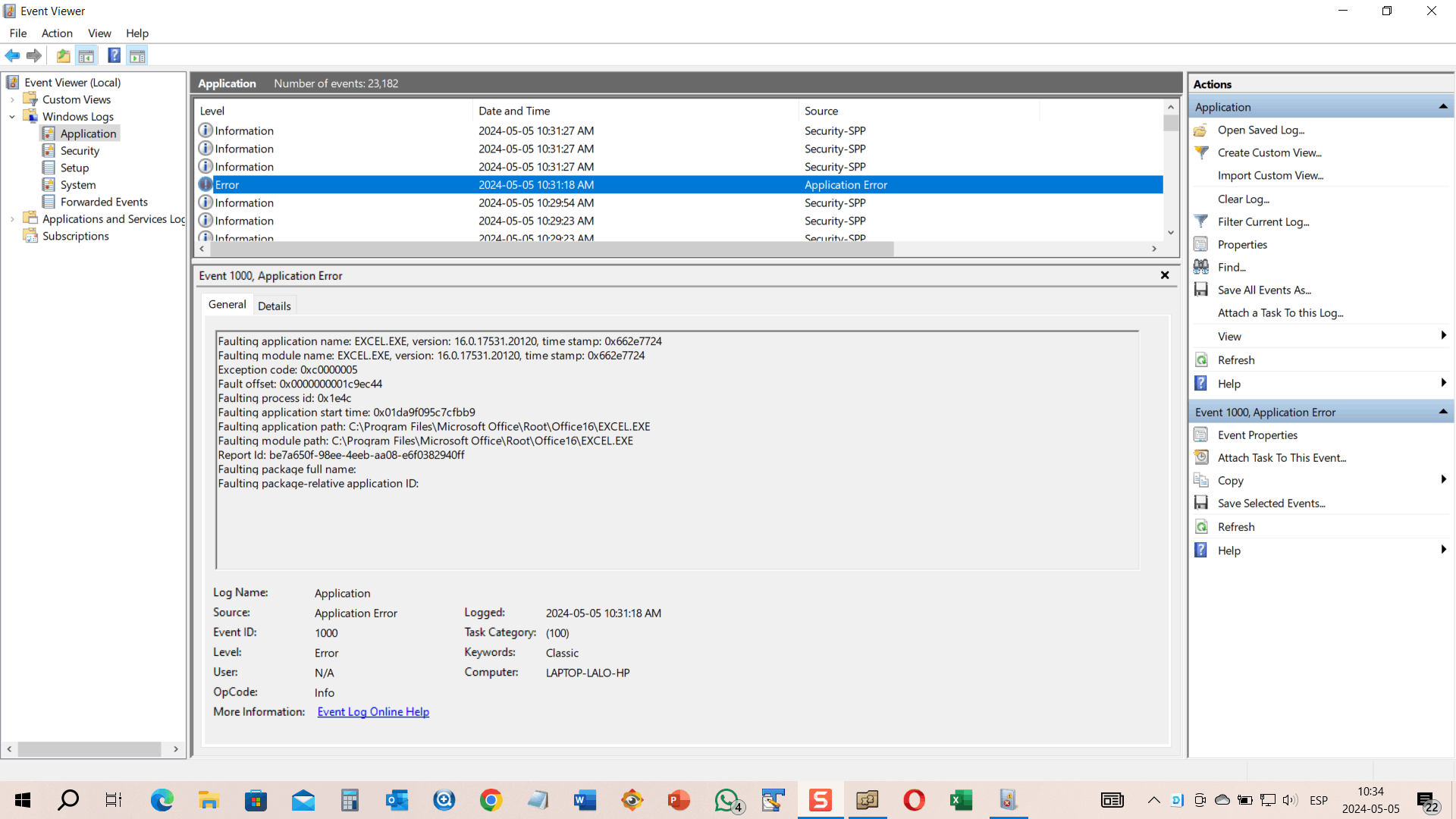

    Hello !!!
    After weeks of Excel running nicely, a few minutes ago I got an Excel error. I am running Version 2404 Build 17531.20120. I was saving a WB when the error occurred and I noticed Excel took some extra time to perform the saving. Right after saving was "done", Excel started automatically offering to recover the WB I had saved. I accepted the offer, the WB opened and I saved it. WB and VBA contents were OK. Nothing was lost. Next is a print screen of the Event.

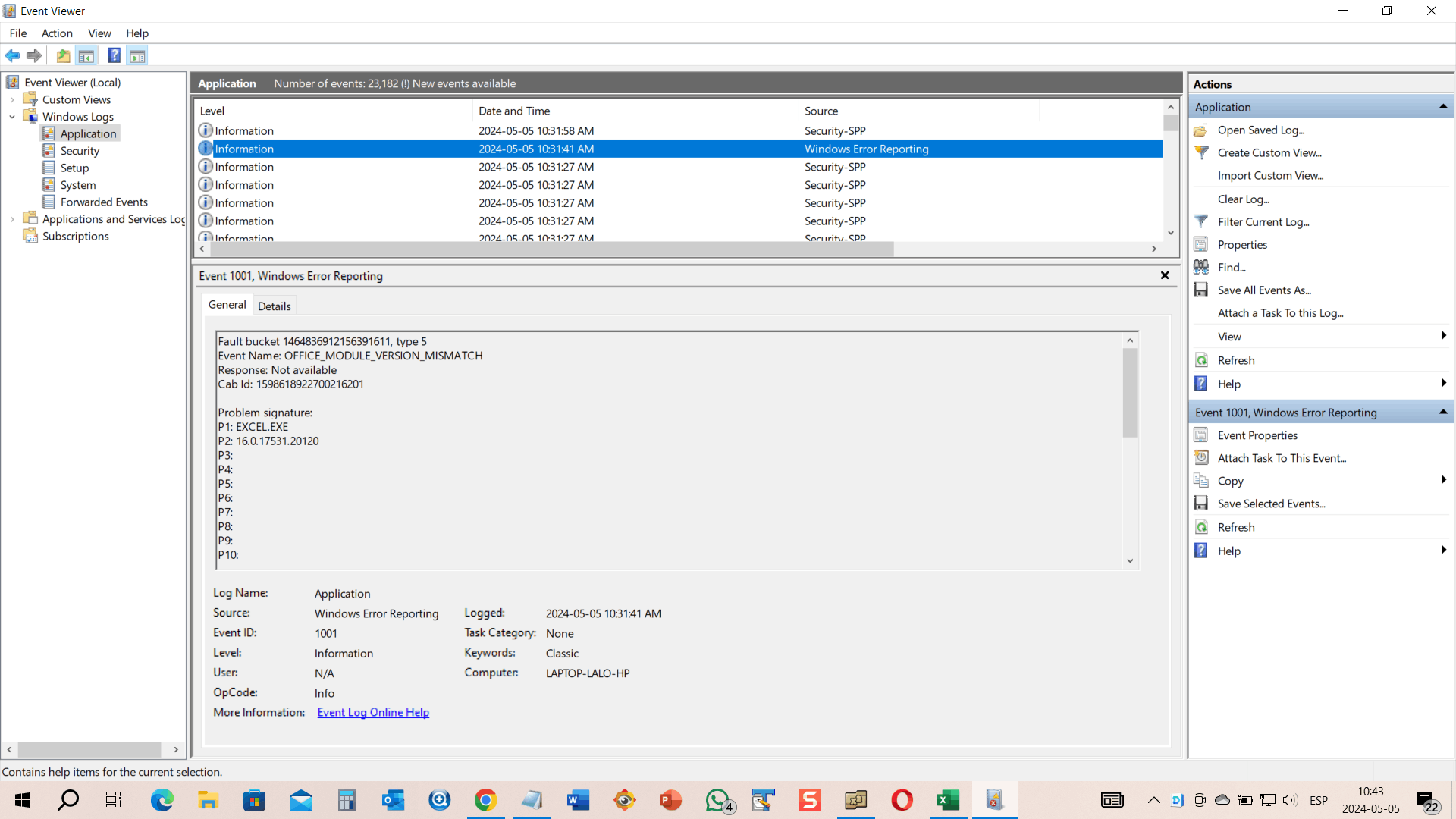

    I also noticed another event that called my attention.... it was an Information Level Event but its contents were related to Excel... here is the print screen:
    OFFICE_MODULE_VERSION_MISMATCH ??????
    What is that?
    Cheers
    Ed
    2024-05-06T06:47:17+00:00
    Yes. I've had similar. Excel just hangs but doesn't crash. The blue circle just spins indefinitely.
    I have to stop it in the Task Manager
