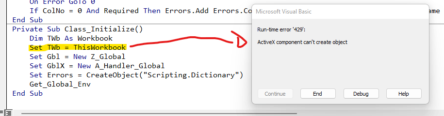

Hi, after updating to Version 2311 (Build 17029.20108), we face seriously many issues with our Excel Macro solutions. Something we have never seen before (or at least not for a long period of time). Even things like standard commands like thisworkbook fail. We had to change to 'Monthly Enterprise Channel 2310', which fixed the issue.
Also, it happens on different computers, with different workbooks, so it's not a question about reinstall Excel or something like that.
Btw. We have been working with Macros as our Core business for more than 8 years, and have millions of lines of code. So we normally know what we do.
Is there other people in here which get the same kind of errors with VBA using this version?
