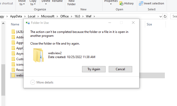

    I do not recommend performing the Repair online except as a last resort. This was the first method I tried and it did not fix the HTTP Error 400 code. Not only does it take a while to redownload Office and install, it also asked me to re-enter my office key for product activation. So make sure to have your Office Key ready if you intend trying the Repair Online method, unless its linked to your Microsoft or corporate account. Clearing the webview2 folder did not fix the issue either, but again thanks for the suggestion.
