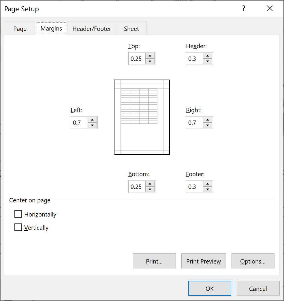

    I am running into an issue when tryin to save the document as a pdf. I have been looking to see if I can find a fix for it, but I am having trouble. The invoice that you created will save as 1 page in a PDF, but the invoice that I created will print on 1 page, but when saving it as a pdf it will not save as 1 page. Below are some screenshots that show the issue.
    Here is the code I am using.
    Dim saveLocation As String
    Dealer = Range("D5")
    Invoice = Range("D2")
    saveLocation = "\TIMS-COMPUTER\Users\furnd\POS System\Invoices" & Dealer & "" & Invoice & ".pdf"
    'Save Active Sheet(s) as PDF
    ActiveSheet.ExportAsFixedFormat xlTypePDF, saveLocation
    Here are my margins.
    Here is the screen in excel that will print as 1 page.
    Here is how it looks when saving to PDF.

    Hi Tim
    Good morning
    From the pictures I would say it is a case of the columns width adjustment
    1st Try by narrowing down the Item description column
    2nd if necessary
    On the layout ribbon tab.>> Paper Margin>> Select Narrow
    Once you do that the PDF macro and print should match.
    Do let me know if you need more help.
    Regards
    Jeovany
