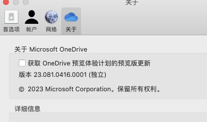

Thanks to carlos andres gonzalez1 and many others who have reported success with the latest "insider preview" version of OneDrive for MacOS (23.081 and later). Reports indicate that the following versions (which are "insider preview" as of the date of this update) have restored functionality with MacOS 10.15.x (Catalina):
* 23.081
* 23.086
Huge thanks to MICROSOFT for fixing the problem! (I have to admit I doubted they would. So glad to be wrong.)
Prior to the release of the above insider preview versions, the last versions of OneDrive working on MacOS Catalina were these:
* 23.002
* 23.054
These are the OneDrive versions that DO NOT work on/with MacOS Catalina (with roll out dates):
I have installed 23.081 and can confirm that it launches and syncs.

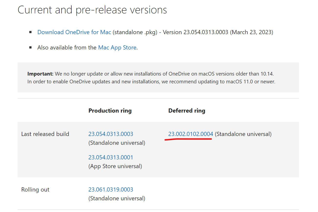

A. Uninstall non-working OneDrive installation (e.g. 23.061.0319.0003, 23.066.0326.0005, etc.)
B. Download older OneDrive version 23.002.0102.0004 (deferred ring)
C. Prevent OneDrive from automatically updating itself to 23.061, 23.066, or later
Step A: Uninstall non-working OneDrive
  1. Using the Finder app, GO to “Applications” folder
  2. Scroll down to OneDrive
  3. Right click on the OneDrive app and select “Move to Trash”

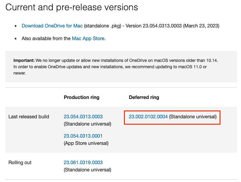

Step B: Download and Install older version of OneDrive
  1. Download the 23.002.0102.0004 (deferred ring). The MS download site is this: https://support.microsoft.com/en-us/office/onedrive-release-notes-845dcf18-f921-435e-bf28-4e24b95e5fc0?ui=en-us&rs=en-us&ad=us#OSVersion=Mac ); do not install from the Mac Appstore—that version has already been updated to 23.061.0319.0003 or later
    1. Others report success with version 23.054 (I also had early success, but I've since learned that it updates too aggressively)
    2. Alternate site for older versions of OneDrive: https://hansbrender.com/all-onedrive-versions/#tabmac

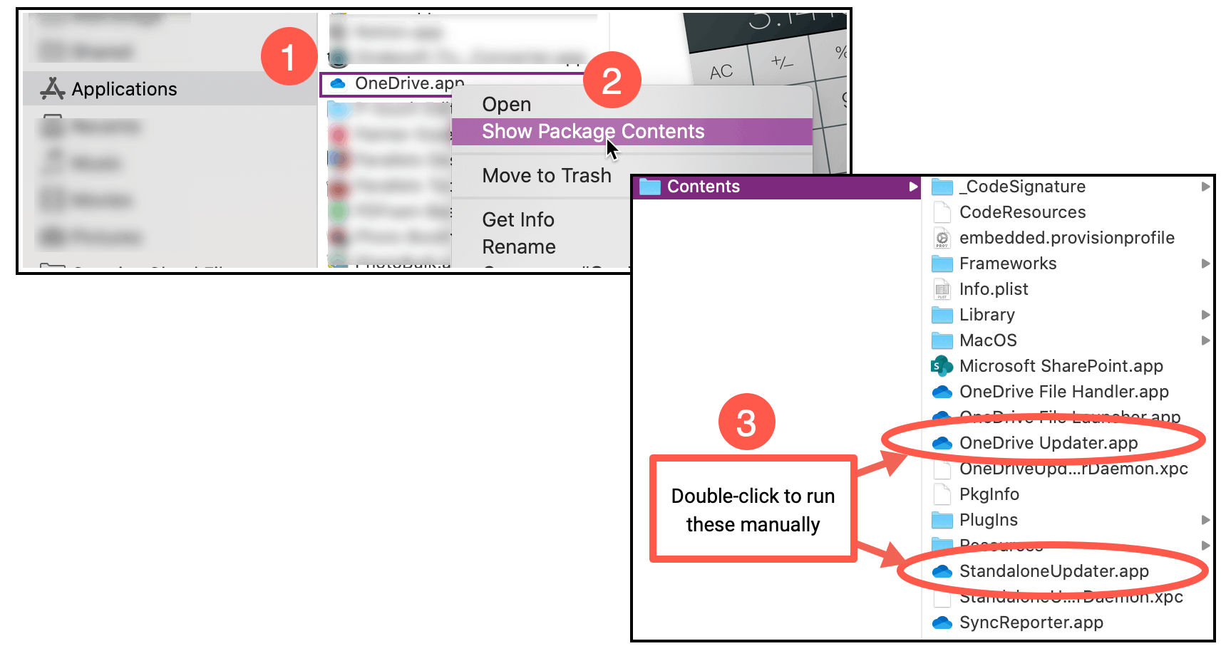

  1. OneDrive will attempt to auto update every time you log back into your computer and at some time interval when you are logged in
  2. The key offending process is StandaloneUpdater
  3. I've tried the following solutions to defeat StandaloneUpdater, but they don't work as long term fixes:
    1. Renaming or removing StandaloneUpdater or OneDriveUpdater, etc. (OneDrive will not run if you do so)
