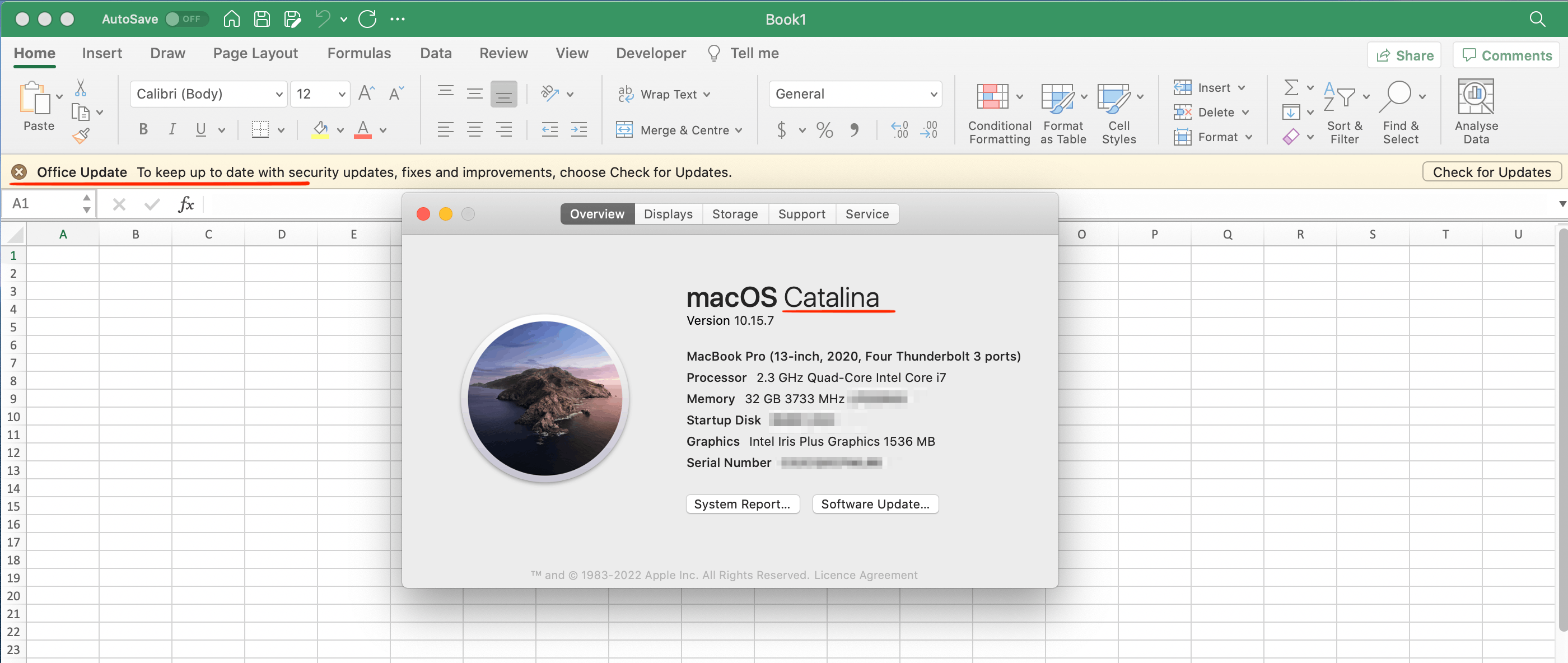

My Fix for OneDrive on MacOS Catalina (10.15.x)
5th UPDATE: 29 Apr 2023 (at the top, new way to solve OneDrive issue, supersedes everything else below it)
4th update: 25 Apr 2023 (appended to 3rd update, found at the bottom, below)
3rd update: 23 Apr 2023 (appended to 2nd update, found near the bottom, below)
2nd update: 18 Apr 2023 (now obsolete, but preserved to help with reversing the fix)
1st update: failed to record date (content replaced by the 2nd update)
Original Post: 11 Apr 2023

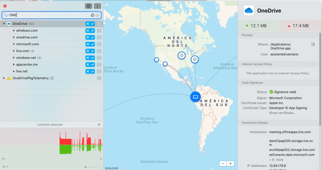

3rd Party Firewall
If you installed and enabled a 3rd party firewall (as I did), you can simply do any of the following: disable, quit, or uninstall.
In my case, I had installed Lulu. I disabled it first. I then downloaded and installed OneDrive version 23.081. Once I confirmed 23.081 was working, I uninstalled Lulu. (The new OneDrive version works with Lulu installed and disabled.)
In my experience, there was no need to first uninstall my current OneDrive version. I simply installed version 23.081 over version 23.002 (after I first corrected the hosts file and disabled my 3rd party firewall).

  1. I use Lulu from Objective C, others report success with Little Snitch. Both appear to be free.
  2. For Lulu, download from here: Objective-See: LuLu. For Little Snitch, here: Little Snitch (obdev.at)
    • You should download and install Lulu or Little Snitch before you install OneDrive.
    • And then install OneDrive (with Wifi off).
    • Before launching the new OneDrive installation, continue with the steps (e.g. below) to block StandaloneUpdater. Best to do this before turning wifi back on and/or running OneDrive for the first time after the OneDrive install (because as soon as OneDrive launches, the StandaloneUpdater will instantly try to force an update—so this Lulu or Little Snitch shield has to be up and running before OneDrive gets to run)
  3. Assuming Lulu, after installation, go to Mac System Preference > Security & Privacy to give Lulu the necessary permissions
  4. Within Lulu, "Add Rule" and select StandaloneUpdater to block it. I also block OneDriveUpdater. (e.g. see 1st Lulu screenshot below)
  5. You can allow Apple apps and other 3rd party apps to run/connect, just not StandaloneUpdater (e.g. see 2nd Lulu screenshot below), so Lulu bothers you less with permission requests
